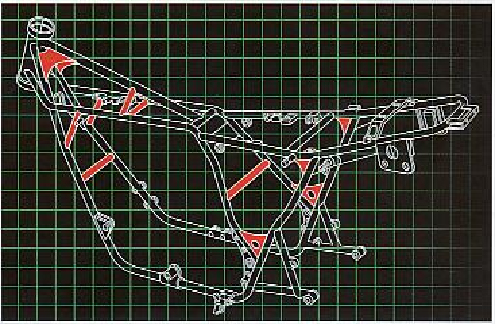

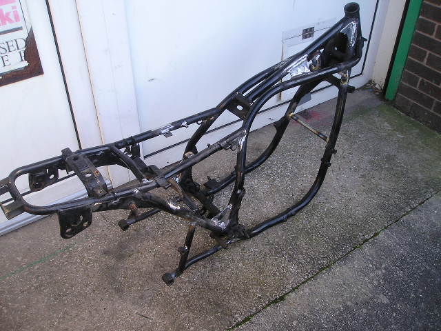

Post by Kwakked Up »
Just figured out how to post pics ...yeah I am a tad slow but ya get that
I was going to post a pics of the big girl but have to figure out how to shrink a pic so will do that when I have more time. Anyway the bike is now in bits and am about to clean up the frame and get some work done, I have found some info on where the gussets etc go on the frame. This one is from a Jap website
This one from a Jap website
frame brace 2.png (210.38 KiB) Viewed 20095 times
and this from a pommy rebuild
pommy one
pommy one
frame brace 1.jpg (76.33 KiB) Viewed 20095 times
there are plenty of similarities but a couple of differences. the Jap one has a rod across the rear of the two cradles and has no gusset at the top front of the triangular section just under where the front of the seat would be like the pommy one.
Does it matter which one or are there more better ways to go :?

Re: 1977 z1000 a1 - modifications
that top photo is the same one I have in my Jap catalogue of Z1 goodies - you must have gone to the same website !
As far as the bracing is concerned, the Jap picture is the best, although in the real world, you will find that there won't be a great deal of difference between that bracing, and the way that the Pommie frame has been braced up.
The most important bit is the bracing up between the top 3 frame tubes, the additional cross-brace between the front 2 frame loops (this should sit just under the header pipes) - you can see its a lot higher in the Jap picture than the pommie frame. be careful with this one, it has to be in the right spot so you don't foul the headers. The bracing at the base of the triangle near the swingarm pivot is also critical.
The next most important addition is a braced swingarm - you will be stressing the swingarm a lot more once the frame has been tightened up. It will make a huge difference again, once you brace the swingarm.
