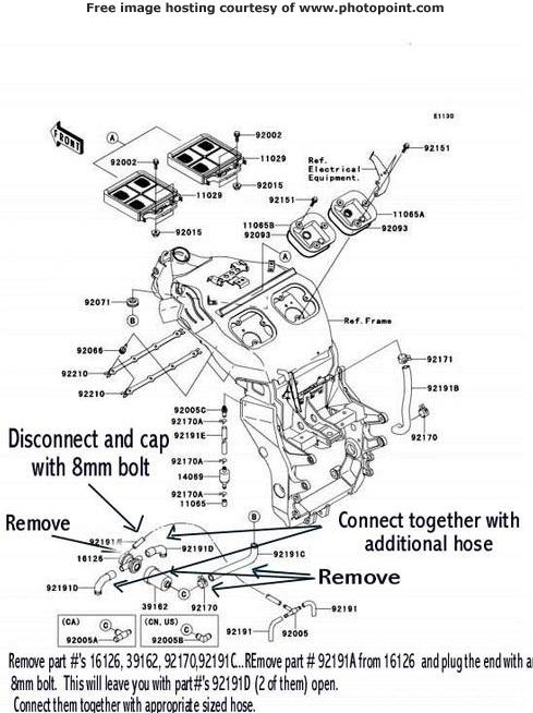

Assumng that it is the same as the 12
make sure you can put it back the way it was if you want to but, there is no need for Muzzy block off plates.
You only want to look at the bottom bit. These hoses go into the top of plates on top of the valve covers, just feed take out the t-piece (keep the canister etc just in case) and put a straight bit of hose in so they feed to each other. Hope this helps Mike its a real DIY. :wink:

i just used electrical tape and covered over the ends of those two pipes, instead of adding more pipe to connect them together. The benefits are that it gets rid of that crackling noise when u come off of hard acceleration. Sometimes there's still a little noise, most likely due to the fuel hitting the cooler air in the muffler.
I have a J1 zx6r, and i blocked off the airbox pipe too with electical tape. U get to take a fair bit of crap out, dosent weigh overly, but every little helps.
