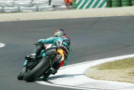

Couple of years ago at the Island the Foggy Petronas machines were shooting a 4 to 5 foot flame out the exhaust as they braked into turn 2. Awesome to see - and amusing to watch the reactions of the following riders!
Kinda like this, but heaps bigger.
Slow and wobbly wrote:....Kinda like this, but heaps bigger.
