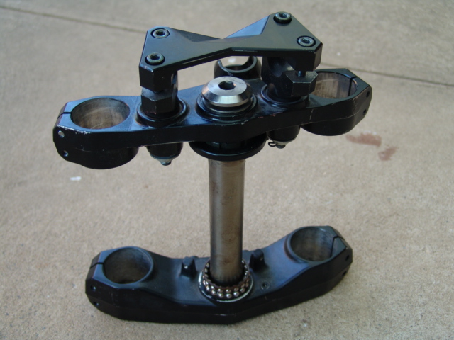

Update: got the Zed 1000 parts today & have the engineer lined up to CNC the bottom clamps to fit the new forks.
The tripple trees & bottom yoke are the only parts from the Zed1000 needed for the upgrade
Cool..........its all lookin' good mate. Whats the deal with that bottom race, are they caged ball-bearings ?? :shock: pretty wild .....
yes & no Gos the top race is sitting on the bottom race but these will not be used a new set are on order..... these ones have been sitting around a while & have surface rust.

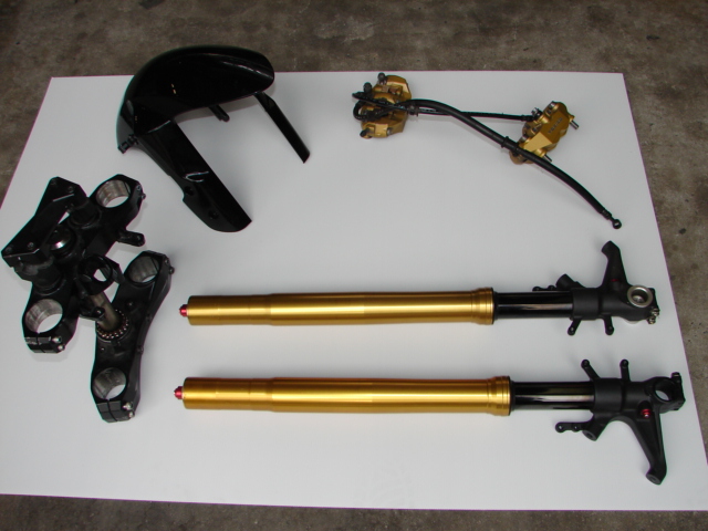

Update:
Have shocks, calipers, Guard & triple tree!
Will have the wheel spacers next week & have double checked the bottom yoke that will get CNC'd next week from 52mm to 54mm to fit the gixxer 1000 forks. I will start the the conversion once I have all the parts ready so not long now! :D :D :D

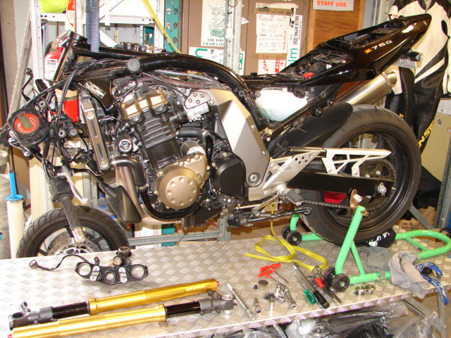

Update
As shown below the conversion has started, I should be ready to start fitting the new front end in the next few days just waiting for the CNC of the bottom triple tree before fitting.
pictures 009.jpg (152.18 KiB) Viewed 4650 times
