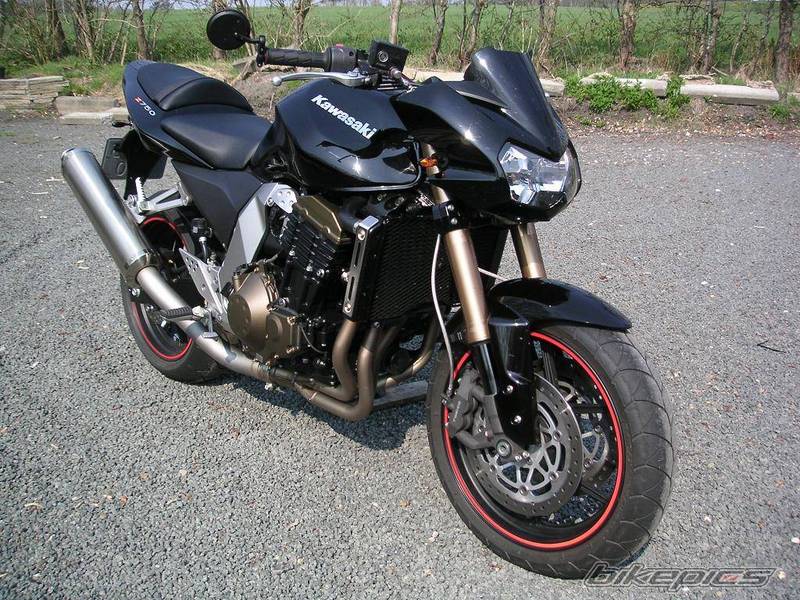

Heres a pic of Henrik's conversion isn't it sweeeeet!
front end.jpg (131.11 KiB) Viewed 8438 times
:shock: that looks GREAT mate, and if you didn't tell anyone, I don't know many punters who would pick that for a Gixxer one anyway.....

I have an engineer ready to make up the spacers from professional drawings supplied by henrik & CNC the bottom yoke.... I might start to pick up bits on the weekend qcheerleader.gif
