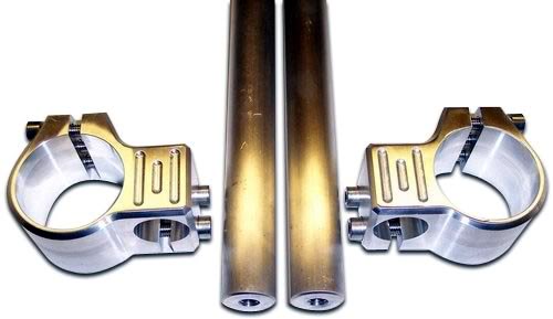

I purchased a shiny new set of clip ons, and have mounted them under the triple clamp. The bars are now significantly lower, perhaps 80-100mm. There are many more mods happening, so I cannot test ride the bike but just sitting in the shed it feels great - like a race bike.

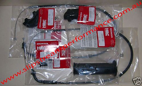

Now, while I had the front end stripped, I decided to add a bit more bling. OK, more like when I was on the net buying the clip ons I purchased a bit more bling. First on the shopping list was a HRC 1/6 turn quick action throttle. Stock the throttle is about 1/3 turn, I had a Rifleman insert bringing that to 1/4 turn, but I wanted more The HRC unit comes with a whole new throttle housing, as the 1/6 turn throttle tube does not fit in standard housing. It also came with new cables as the outers are a different length.

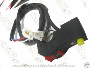

By fitting the new throttle housing I ran into another snag – no switch gear on the HRC throttle housing, so I purchased a new starter button/kill switch which I believe comes from a modern dirt squirter.

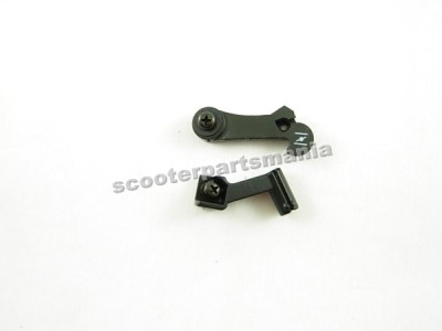

As the switch gear was being removed from the right hand bar, I thought it best to remove the left switch block too. Only problem here is that the stock road unit had a built in choke lever, so I went back online and found a bracket and lever to mount the choke elsewhere.

So far the clip ons are on, the throttle is on and the cables are half fitted. I just have to get them in place on the carbie. The starter switch is here on my desk waiting for my next shed session. The choke lever is expected to arrive Monday. I also have a nice shiny new shark fin for the swingarm, which will be fitted soon.

I've got the same clip ons fitted to my ZX9R can you post a pic of them underneath your top triple clamp? I'm thinking of doing the same. By the way nice mods you've done, I'm a huge fan of the shorty pipe also.

Clip ons are on, don't hit the frame (just), lock is OK without the stock Honda giganta-clocks. Am still to source a rev counter and fairings have not yet been modded...
HRC 1/6th turn throttle and cables are fitted - what a bitch. Did the job without releasing the carbies, and the return cable was almost impossible to fit. Once that was done everything was a little too tight (Slow return particularly on right lock. Cut 5mm out of one outer cable and she’s as good as gold. This mod will hence forth be known as the HRC throttle on/off switch.
Kill/start switch is also installed, and again a complete arse to do. Stock start button has 4 wires for the start and two for the kill switch. The new switch block has two wires for each. The extra two on the stock unit are to allow for all the safety mumbo jumbo switches. It’s really a set of inline switches; side stand, neutral and clutch. Once the “in and out” were located, it was a case of bypassing and looping from kill switch to start button. Took quite some fiddling, a good while staring at circuit diagrams, a new connector block and a soldering iron, but got her started about 6pm.
