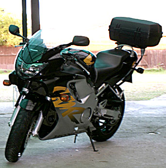

The starting point
The track day version

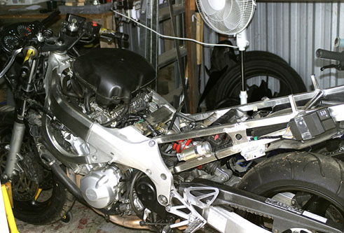

All none essentials have now been removed
The ride height was raised using two washers at the top of the rear shock adding 3mm to its length. Being a 45 degree shock, this raised the rear quite a bit.

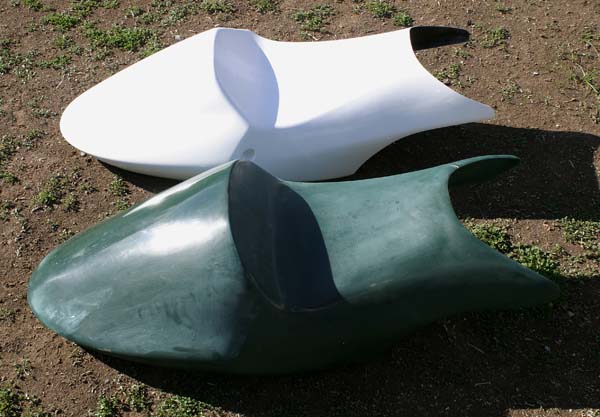

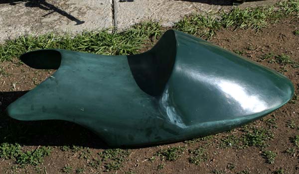

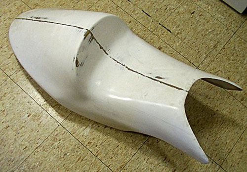

Although I have ordered a full set of race glass from Racers Edge, I acquired a solo seat unit cheap from ebay.

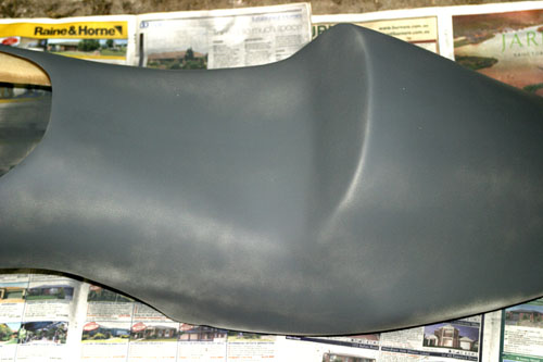

This was Etch Primered using a superb arsehole can...
The next stage is to decide on a final colour and learn to paint. I am playing with something akin to British Racing Green at the moment... more to follow.

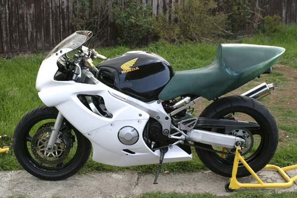

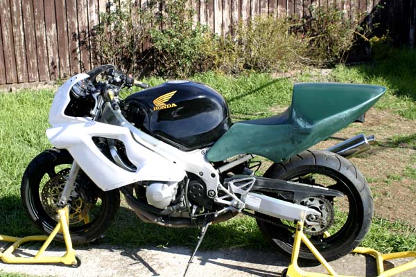

Had a bit of a delivery today, and spent the rest of the day in the shed.
Again the starting point, raised rear, removed pillion pegs & brackets, removed hero blobs from pegs and put new oil in the forks. Static sag set to 30mm.

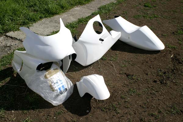

Then this arrived from Races Edge

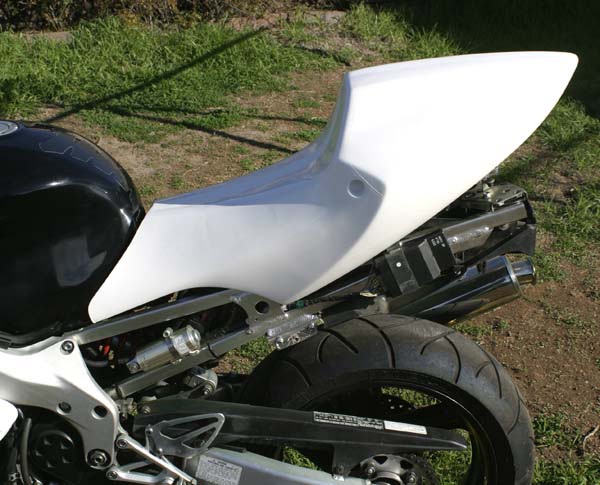

The tail unit is really small and will require a few bits to be moved around, but will look great once it's done. Luckily I have another unit (as above), and this fits the rear as it is now. It has been painted but not fully polished yet.
The top half of the fairings went on really easilly, and drilling the holes was far easier than I expected.
The bottom fitted easilly to the top, and stays snug with the supplied 1/4 turn duzz fastners (wire lock type).

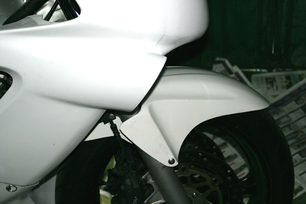

Finally the front guard slipped on, although I had to remove the front wheel to get the bolts done up.

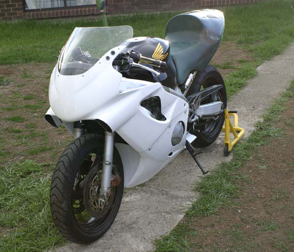

Still have to refit the ram air ducts, but apart from that it's done. Will get the painting finished after the track day at PI on June 11th.

Will polish the seat unit, don't know about painting the rest yet.
