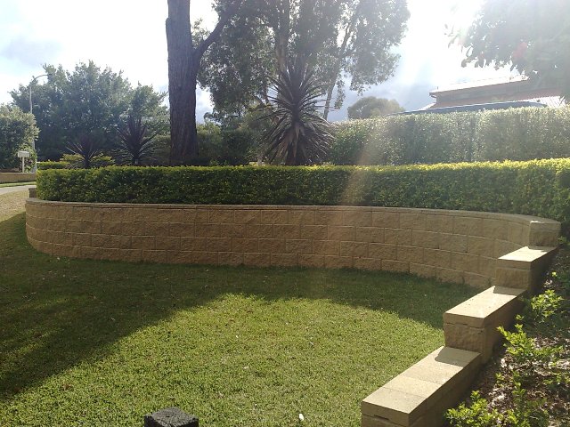

aardvark wrote:Firstly... Rob, they don't have water restrictions in your street?? :shock:
The shot was over 2 years ago pre restrictions.....these days I hand water when I can :roll:
Below is a shot from a few weeks ago:
aardvark wrote:After I had it filled, I climbed up and looked over the neighbours fence and what do I find? They've got themselves a retaining wall with soil up against the fence! At least if it rots out, it wont be my fault. :D
That's a classic mate :lol: :lol:
