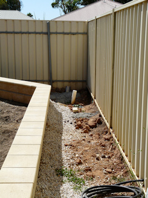

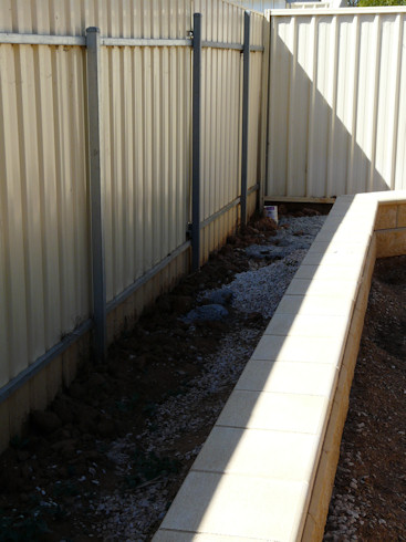

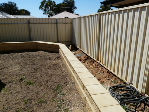

Thanks for the input so far guys. Glad I went out and took the photos - reminded me that one fence is post and rail.
- fence 1.jpg (104.94 KiB) Viewed 2303 times
- fence2.jpg (69.82 KiB) Viewed 2302 times
- fence3.jpg (71.25 KiB) Viewed 2302 times

Arrdy, between the fence and garden wall is quite high, this could over time push the fence over. Depends whats on the other side. I would build a small brick wall along the fence or put wooden planks standing on there own, not against the post, so no soil gets near it,then fill it in mate, just to be sure.

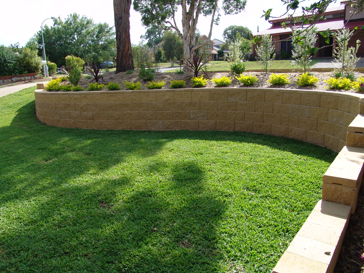

Mate here is a little one I did 2 years ago ... 2 hours every arvo after work + 1/2 the weekends in the summer heat & took 6 weeks to complete.aardvark wrote: It took enough effort to build the damned retaining wall!
I also have a retaining wall that backs onto a colourbond fence & I used 2 layers of black building plastic between the soil & fence, the height is about 500mm
& is about 400mm deep but is only a garden bed & not for walking on ....... 2 years on & the fence has not bulged, moved or showing any signs of corrosion.
I will try to get a pic
Edit found a smaller pic of the back wall against the fence (drainage under the fence)
