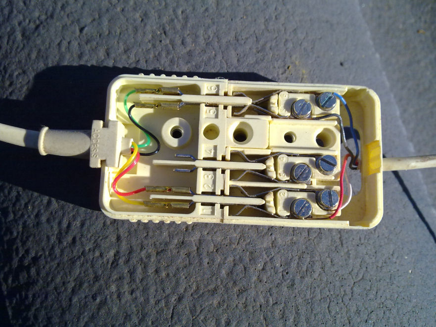

I'm going to get up on the roof later and have a look
- seiko1
- Posts: 7643
- Bike: ZX14R
- Location: Geelong
Re: Any Alarm Specialists here
Shit I give up
Found this in the roof today, unplugged it which totally took the alarm out of the equation No difference whatsoever FFS
Connection Speed down 5663 kbps up 1020 kbps
Line Attenuation: Download 55.5 db Upload 30.0 db
Noise Margin 6.70 db 11.0 db
There is nothing else on any of the three outlets, no filter, nothing!!!!!!!
WTF?
WTF?
Apparently it's the noise causing it to gradually slow down to dialup speed.
But I think I have cracked the problem
The wire I looped yesterday that went to the alarm has four wires, two are active phone line and the other two return
the line back some ten or more mtr's to where it splits off to the other wall sockets.
That would be creating a magnetic field because there is voltage running in opposite directions
billimetres apart on unsheilded pissy little wire.
What do ya reckon? (56db of noise is to much they say)
Connection Speed down 5863 kbps up 1020 kbps
Line Attenuation down 54.5 db up 30.0 db
Noise Margin down 5.50 db up 12.0 db
Noise down slightly...speed up slightly!!!
but the longer I'm online the slower it gets..........

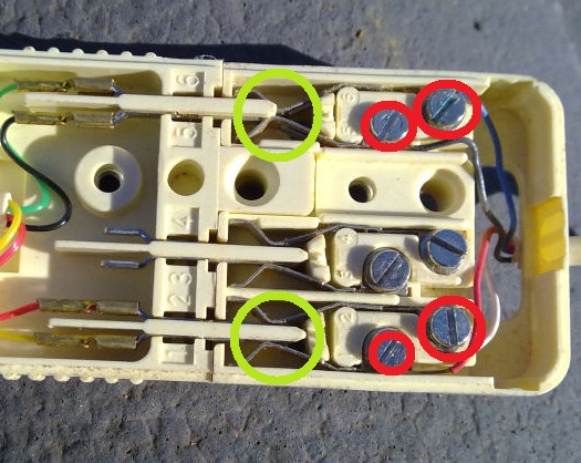

When the alarm plug is removed, the contacts (green circle) join to complete the circuit. These could give a bad connection. You could remove the black wire and join with the blue. And also join the red and white wires. Just place them under the same screw post. It will eliminate at least 1 problem point.
That was the first thing I did after finding the plugwoteva wrote:When the alarm plug is removed, the contacts (green circle) join to complete the circuit. These could give a bad connection. You could remove the black wire and join with the blue. And also join the red and white wires. Just place them under the same screw post. It will eliminate at least 1 problem point.
I'm going to have a few beer's and then get back up on the roof, follow that bastard wire (inside the hot roof
and see where the junction is, after I find it at least the voltage will all be going in the same direction
Cheer's and stop thinking so much on a Sunday
Connection Speed Down 5976 kbps Up 1020 kbps
Line Attenuation Down 56.0 db Up 29.5 db
Noise Margin Down 6.05 db Up 11.0 db
After removing 20+ mtr's as it turned out, of two way line, the speed and reliability has improved....but that friggin noise!!!!!!!!!!!!!
