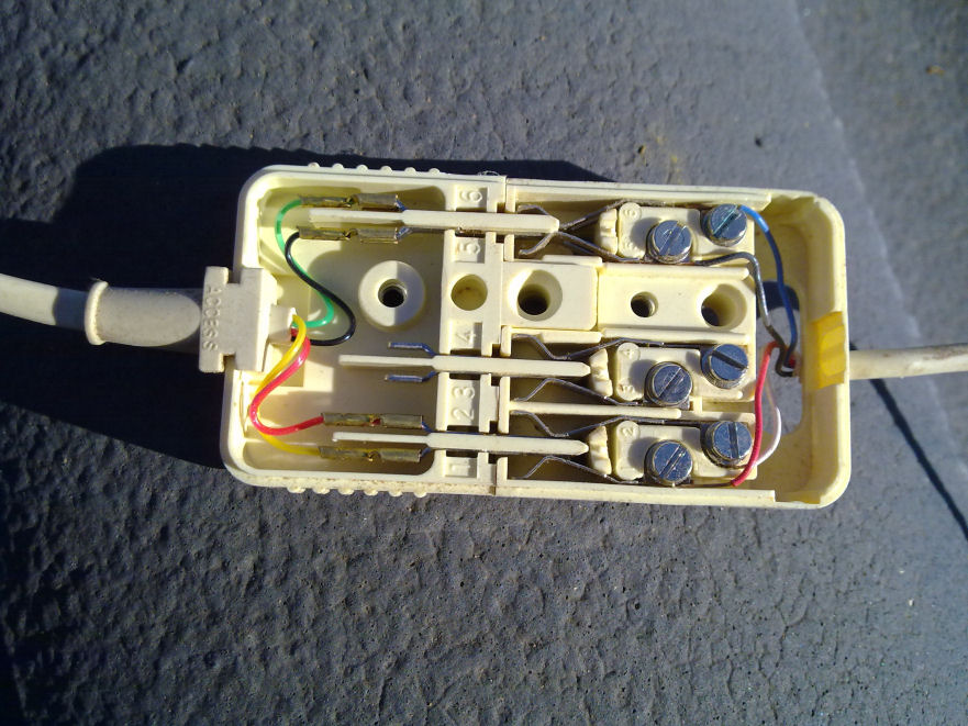

Re: Any Alarm Specialists here
Posted: Sat Jan 08, 2011 8:57 pm
by seiko1
Shit I give up :roll:
Found this in the roof today, unplugged it which totally took the alarm out of the equation
No difference whatsoever FFS :x
Connection Speed down 5663 kbps up 1020 kbps
Line Attenuation: Download 55.5 db Upload 30.0 db
Noise Margin 6.70 db 11.0 db
There is nothing else on any of the three outlets, no filter, nothing!!!!!!!
WTF?
Posted: Sun Jan 09, 2011 1:20 pm
by woteva
When the alarm plug is removed, the contacts (green circle) join to complete the circuit. These could give a bad connection. You could remove the black wire and join with the blue. And also join the red and white wires. Just place them under the same screw post. It will eliminate at least 1 problem point.
Posted: Sun Jan 09, 2011 4:23 pm
by seiko1
woteva wrote:When the alarm plug is removed, the contacts (green circle) join to complete the circuit. These could give a bad connection. You could remove the black wire and join with the blue. And also join the red and white wires. Just place them under the same screw post. It will eliminate at least 1 problem point.
That was the first thing I did after finding the plug ;)
I'm going to have a few beer's and then get back up on the roof, follow that bastard wire (inside the hot roof :roll: )
and see where the junction is, after I find it at least the voltage will all be going in the same direction :D
Cheer's and stop thinking so much on a Sunday :D
