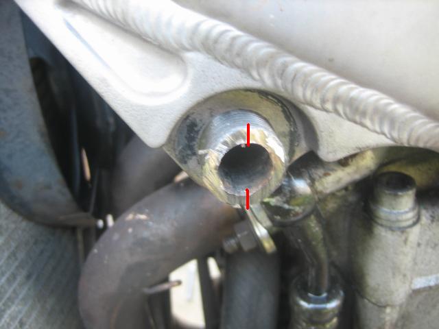

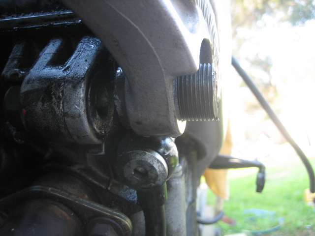

now i feel like a real dick head :( today i went and bought the 14mm hex socket had to pay $20 for it today or wait untill tomorrow for $10 i couldnt wait i also went and bought a air impact wrench seems i didnt need it with a 1/2" crack bar and the hex socket the bolts came loose now these is where i feel like a dick head i was just thinking about getting rid of the bike when i grinded off the hex section of the bolt and used washers to center the engine now i am going to atlease get the bike on the road and look at the bolt how would i get this undone? the bolt comes out thru the engine side it doesnt unscrew out of the frame so a ezi out wont work as thats a reverse thread :(

any idea on how to remove it? it just needs to be cracked like the others than it will undo by fingers

get a bolt that fits into the centre of that one and weld it there,or is it a alloy bolt that you cut the hex head off
Re: Engine Mount Bolts Seized
Cut a slot in the end with a cut of wheel ;)

like this? im clueless what will this do?

Cut the slot just wide enough to get a nice big screwdriver onto it sideways, use the screwdrive like a jemmy bar....
or even better if you have a little jemmy bar (pry bar) ;)

the inside diameter of that bolt is 16mm so it will need to be a massive screw driver :( are there any other options that u can think of?
