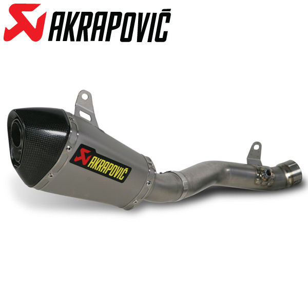

Just need to find a REALLY good tuner and they're hard to come by. What you have there in the picture is an 02 sensoer (Oxygen) which the Euro/Australian ECU'S run. So if you do get rid of the cat and go down the power commander road for smoother curves then you need to install an 02 optimizer from Power commander, also note the one listed on the power commnder web site is not the right one for the Australian model (serco wont sell you it anyway).
The reason it is needed it that the Zx-10's run a closed loop mode in 4-6th gears and from 0-20% throttle and from 0-75000rpm which is why your tuner will be putting the PCV in gear advanced mode. If you dont run the Optimizer/Eliminator the ECU will have a fight with the PCV and not sure what happens besides crap running.
I'll try attach the 02 instructions so it gives you a better idea of what it is doing. Note it is the wrong part number even though it says Zx-10r !! you need 76125020

Yes Valkau as you say it is standard on the Akrapovic link pipe, good luck sorting the tune out mate.valkau wrote:OS Optimiser was the word I was trying to say (it was late after all). Here's a couple of pics of work in progress. You can see the OS sensor in its socket. It seems the socket is standard for Akra link pipes. The mapping is still a challenge as everyone says. I think Ron now has 3 cyclinders running!
- akrapovic_kawasaki_z10r_.jpg (41.48 KiB) Viewed 8945 times
