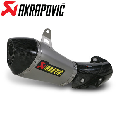

Hi all,
new to this site so i am not sure if this has been covered before, just bought a new Akrapovic Slip on for my 2012 ZX10R, talked to the dealer about it but he wanted to charge me $166 more for the slip on than i ended up paying for it ($891 vs $725) and wants to charge over $200 to install it, he claims it needs to be tuned, decibel tuned and fitted correctly.
Now i am sure i have read in several Magazines (Fast Bikes, Performance Bikes) that because the 2012 ZX10R has a cat and O2 sensor and the slip on goes on after these their is no tuning required as the bike can adjust itself as it is after the cat and o2 sensor, do you guys have any experience with this?

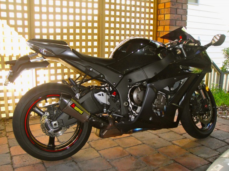

Well I put the Akrapovic slip-on on today,5 bolts all lined up like clockwork,copper paste and ceramic paste all supplied with exhaust,def not worth $200 to install
, took the DB reducer out too thanks Maccarocks,it had a spot weld on the 8mm nut which just about fell off as i took it out of the box
and sounds better

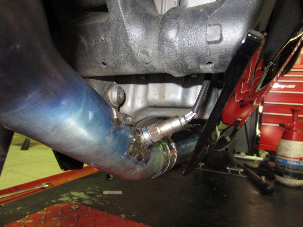

Try to get a link pipe with the os sensor socket a it simplifes remapping. My Akra pipe (from Jonno) has it but I don't know if this is standard. Another thread talked about Yoshi not always having them. It needs a Power Commander or similar if you remove the servo connections as you do when you remove the Cat. It also needs a Servo Buddy and an OS emulator of some sort - either an Eliminator if there is no OS socket in the link pipe or another (forget Help me guys!) if you have the rear sensors like I do.
Ron at Flywheels Sydney is installing the kit and doing the dyno mapping THIS WEEK so I'll report back.

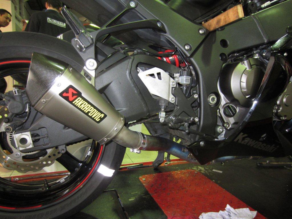

OS Optimiser was the word I was trying to say (it was late after all). Here's a couple of pics of work in progress. You can see the OS sensor in its socket. It seems the socket is standard for Akra link pipes. The mapping is still a challenge as everyone says. I think Ron now has 3 cyclinders running!
- Shorty and link pipe 2.jpg (129.58 KiB) Viewed 13204 times
- Link pipe 2.jpg (105.71 KiB) Viewed 13204 times
