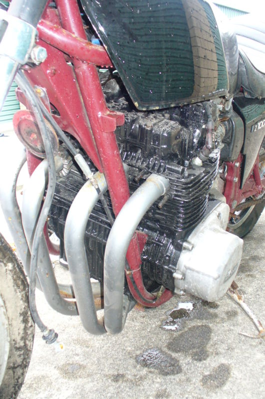

Eastoe wrote:I'm seeing some confusion here.
I see a Z000 MKii but then again it will be interesting to see it in a week's time
That is definitely a MkII motor. The frame also looks to be the later style Z1000 frame. Not sure what the go is with the Z1R sidecovers ? They don't belong on that frame. The engine side-covers may have been changed out for earlier ones, this is not unusual at all....
Unless the cam sprockets have been changed, you normally don't see MkII heads on earlier bottom ends. The early motors run 15 tooth cranks and 30 tooth cam sprockets, MkII motors have 16 tooth cranks and 32 tooth cam sprockets. Although, that engine paint does not look stock to me, looks like it has seen a paint job recently ? Best guess is that you have a MkII and the seller has NFI !
It's as cross bred as a Mt druitt feral cat. :lol:
Re: I.D. a Z1000 I just bought
nah I reckon its a MkII for sure and the seller has no idea. Sidecovers are not stock - but neither is the frame paint :lol:

I still think its a Z1000 mk11 . It the Z1R mk11 with the KZT00D frame no. The 1980 Z1000mk11 -A4 starts with the frame no KZT00A-043001 .But send more photos.
Its a MkII motor/frame combo either way. Much better all round than the earlier Z1000A1/A2. :kuda:

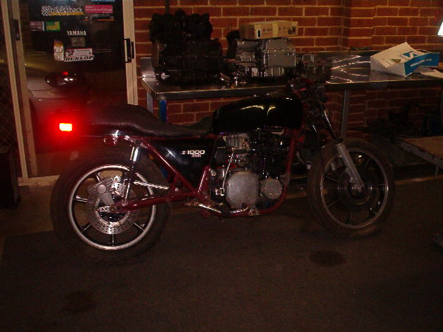

Z1000MkII alright - but that alternator cover is not stock for a MkII motor ? It is the early-style cover. They have totally different internals, you can only bolt one of the early style alternator covers on, if the internal rotor has been changed !
Bizarre - but it matches the early-style points cover and clutch cover. MkII clutch covers only have a polished centre section, the outer perimeter is painted black. Wheels/dics rotors look like stock MkII jobbies......but no calipers ?
geez its a roughy, I hope you got it cheap ?

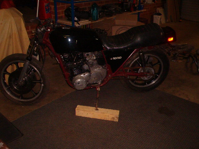

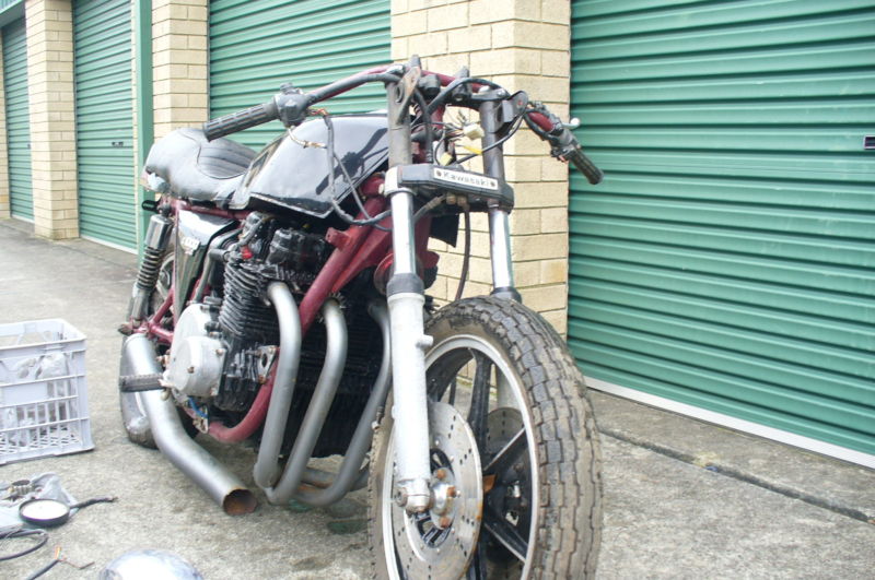

Well, it arrived today and it's pretty horrible but that is what I was expecting. Couldn't help hoping it would be better.
I look at it and can't help saying WTF goes through some people's heads????
Z1000MKII was probably my favourite Kawasaki followed closely by Z1000J, Z1R & GPZ1100/750 so I don't want to talk too soon but it will be good to salvage this one.
:shock: interesting !
well looks like most of the important bits are there mate, some cosmetics and a frame clean & spray - it will look as good as new.
