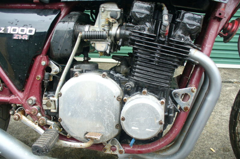

I'm seeing some confusion here.
I see a Z000 MKii but then again it will be interesting to see it in a week's time

Could it be a Z1R MKI with a MKII head?
