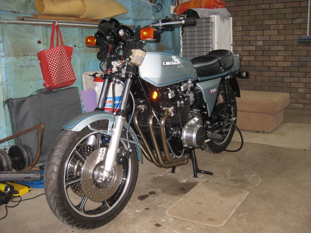

Anyway that was Saturday, Sunday was a "rest day" (went out for the day with the better half.)
Monday being PHol was back into it - off with carbs, on with the aircleaner ass'y and back on with the carbs.
Sounds easy but it ain't - not for this little black duck anyway!
It's a real shit of a job - got to take off the airbox tube clamps and refit them after carbs are in place - not enough clearance
for carb inlet/airbox with clamps on - there's a risk of cutting/tearing/pinching airbox inlet tubes with sharp edges of the clamps.
If those carbs have to come off again it'll be a trip to Mr K&N for 4 filters and C'case filter as well as some bigger jets!!!
Anyway that was a cupla hours worth by the time everything was back together so turned attention to instruments
and got all the dampers, collars, nuts bolts etc laid out ready for install of the gauges, inst panel and headlight - probably tonight.
A photo of the quickly approaching final product for you.

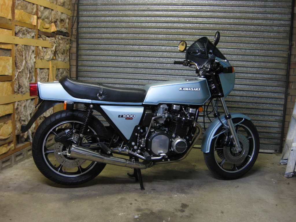

Assembly complete!
After only 4 years and 9 months (and a bit) the Z1-R rebuild is now done.
Had a lot of fiddling and farting around with the headlamp, fairing, instruments as I couldn't get some of the dampers/grommets and had to make my own. Also after fitting/refitting fairing several times noticed that the fairing "wings" were fouling the mirror standoff mounts - probably because the switchblocks that carry the mirror mounts are not Z1-R and the bars may not be either. Anyway decided the easiest way to overcome this was to move the grips outward by 10 mm or so, and all was good. Just have to refit battery (on charge) and go for inspection and rego papers.
A pic taken just after "down tools" last night - will look a lot better after a good clean to get rid of accumulated dust, fingermarks etc and to brighten up the covers and paintwork etc.
Hopefully will get rego done tomorrow and be "on the road!"

Looks sen-fucking-sational!

Looks great Bill...well done you.

that looks really tidy - well done Bill
still need a Z1R in the 4th ......one day.
