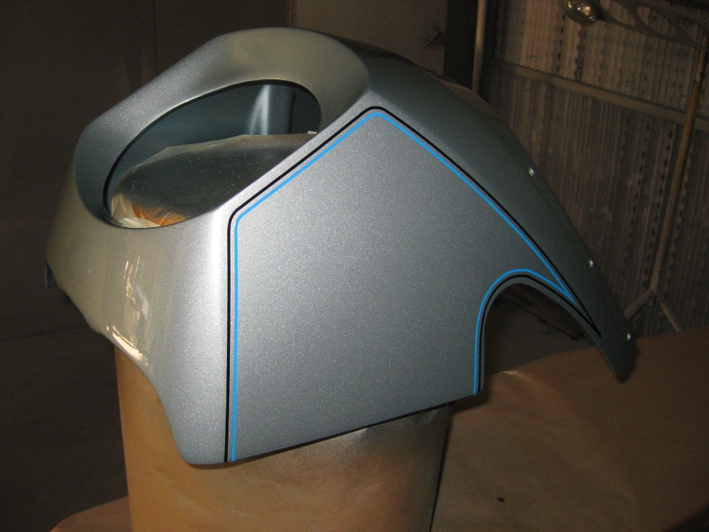

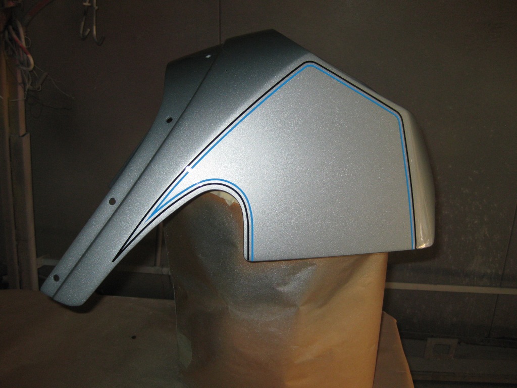

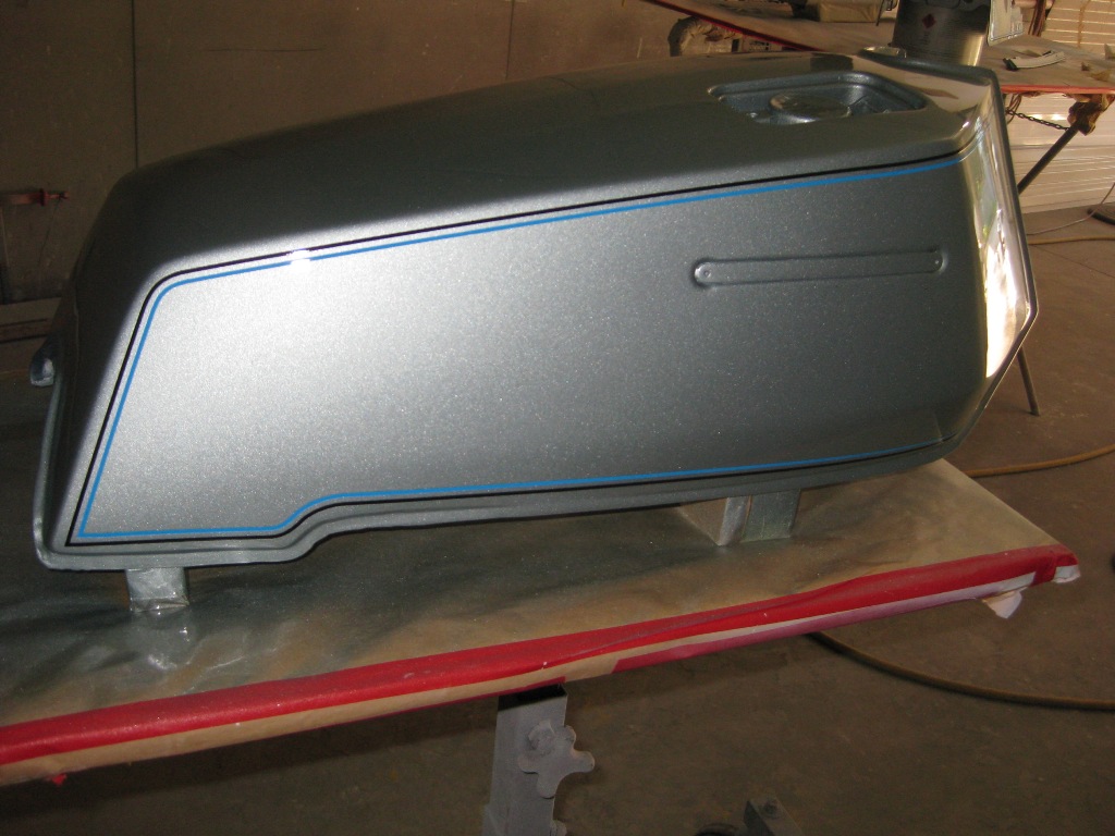

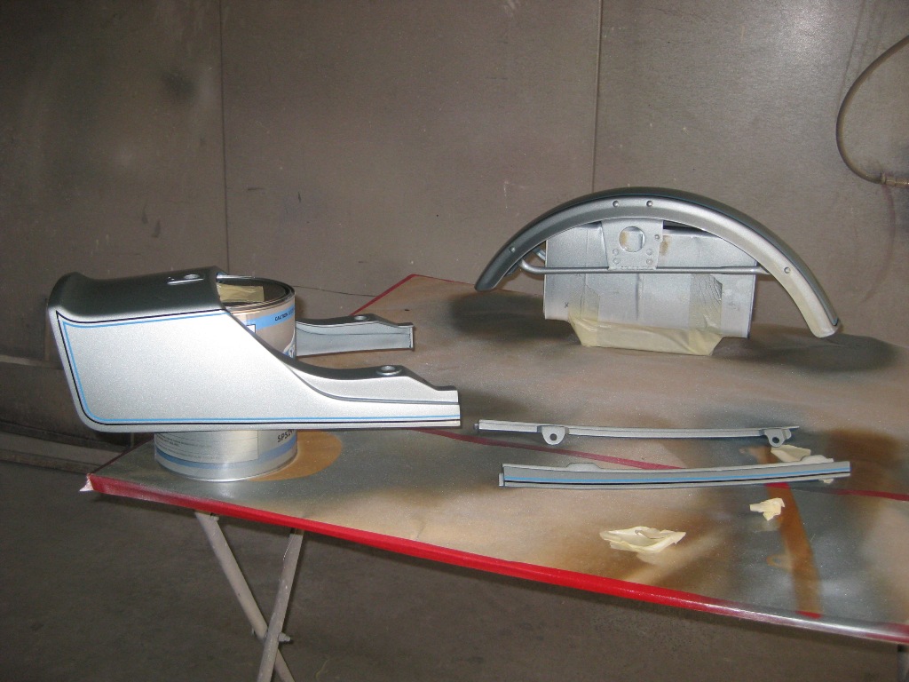

As promised/threatened a bit of an update on rebuild progress.
Got the paintwork back from the painterman - top job, looks' kin amazing!
Few pics for yez to drool over !
- Fairing LHS Repainted.JPG (206.71 KiB) Viewed 76461 times
- Fairing RHS Repainted.JPG (194.69 KiB) Viewed 76461 times
- Tailpiece and Trims Repainted 2.JPG (196.48 KiB) Viewed 76461 times
- Tank RHS Repainted.JPG (199.12 KiB) Viewed 76461 times

Re: Z1-R Rebuild

Re: Z1-R Rebuild
Always the way with projects - just when you think you got it nailed some 10 cent bit shits itself and you're back on ebay sourcing it. I am trying to recommision my Yamaha RD250LC at the moment and spent a good several hours on Monday just generally sorting stuff. Was tightening the clutch perch when crack broke the casting (that's the third one) - so the hateful thing goes back undercover until the new one arrives. Then yesterday smelt fuel to discover one of the bowl overflows is leaking - it will just be crap stopping the seat from sealing as I've been running it on reserve while fiddling - but still have to take the carb off and clean it - aeffingain!!
I guess that's why when it is finished you are satisfied/relieved................................
Also that paint job is excellent - can I ask how much?
PK
"Too many bikes is never enough"
ZXR750H1,GPX750R,GPz600R,750,900R,1000RX,KR250,Z1a,Mach3,Z1300 and..
Re: Z1-R Rebuild
Paint job cost $2,000 - painter was insistent that he did all the prep work - rubbing, filling, puttying, panel-beating as well as the painting, laying of pin-stripes and clearcoat over the lot, so I think money well spent. Logic is that if the paint job fails then it is unclear as to who is responsible if prep work is done external to the professional job.

- Kwakked Up
- Posts: 580
- Location: Goulburn
Re: Z1-R Rebuild
paint looks great, money well spent.

- kawadave
- Posts: 814
- Joined: Sun Nov 07, 2010 7:45 pm
- Location: Bundaberg. qld
Re: Z1-R Rebuild
Paint work looks great Slimey...getting close now.

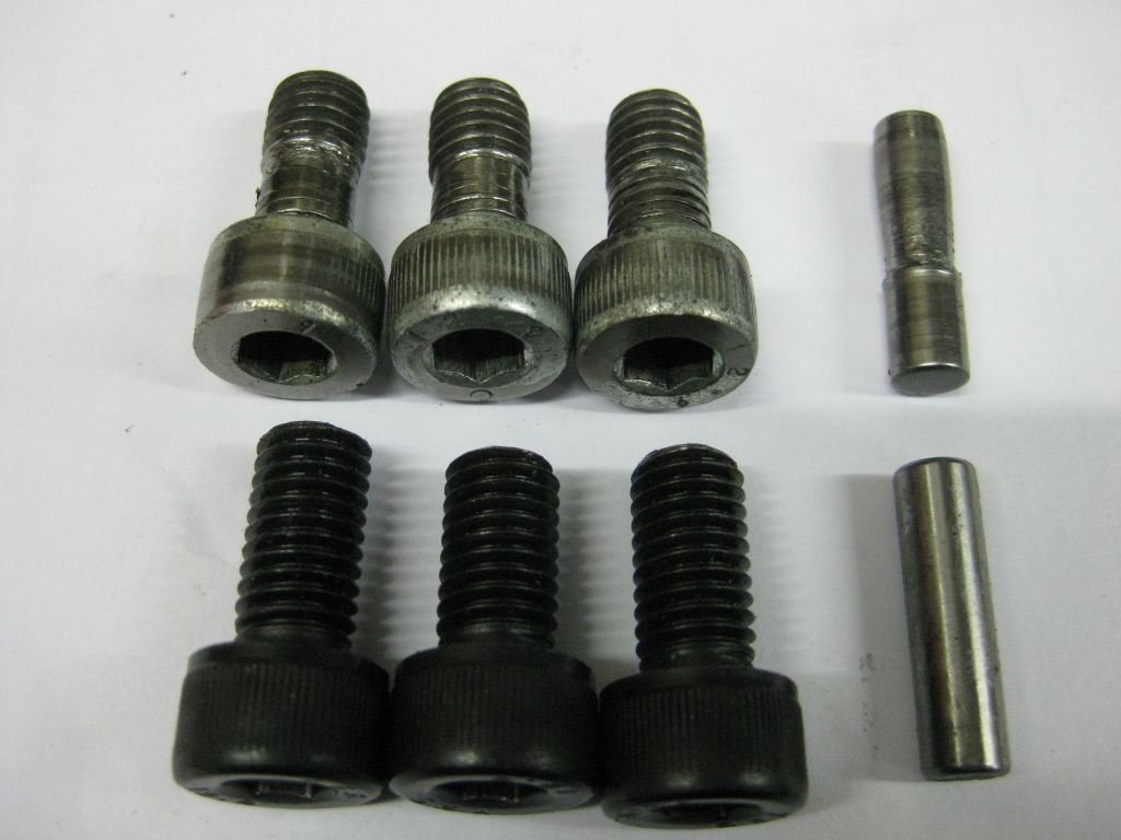

Re: Z1-R Rebuild
Hope to get 'er flashed up this weekend.
Rebuilt the starter motor clutch with new high tensile bolts, dowel pin, rollers, pins and springs.
(see pic of old Vs new bits - no wonder it made a racket, with the bolts and dowel pin rattling around!)
This must've been done by whoever rebuilt the motor and forgot to use decent bolts with loctite
and torque them correctly!
Tried to get the boss on the starter motor gear built up using hardchrome process - went to Chromax in W'gong
and explained the job to the bloke there. He said that he would not be able to do it -
not enough clearance for the metal spray/hardchrome and grinding equipment - Bugger!
In desperation I did order a replacement from Partzilla, was gonna cost me about AUD$500 with shipping and exchange rate.
But after I got my hopes up and placed the order they came back and said "sorry, NLA"
The OD of my clutch gear boss has a minimum measurement which is .020"
below that of the unworn portion near the face of the gear. Has anyone any data on what theirs is please?
I'd like to compare with others to confirm if this is fairly normal.
I can't believe that this small amount of wear would be enough to disable the starter.
I think that the unsecured clutch body wobbling around caused the rollers to slip on the gear boss.
