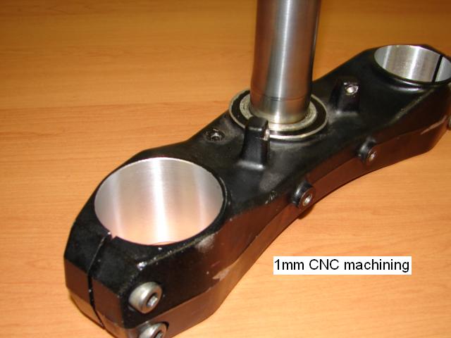

Pic of the CNC work..... a much better finish than stock but I had just noticed that the wrecker did not include the bottom race so it was off to buy a new set $50 + call in for a freebee from mate Mick at CHM to press fit the race before any assembly can take place.

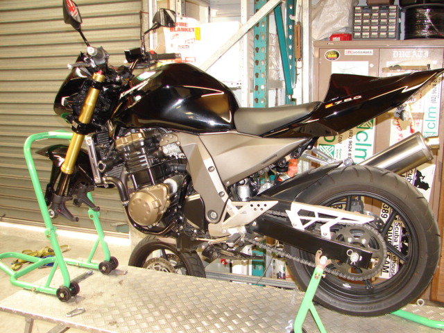

OK the forks are fitted now just waiting on wheel spacers & make up braided lines (next week)..... excitement!

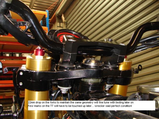

Wrecker in QLD said the TT's were in perfect condition, but they are not!
I will have to touch up in a few places once finished.

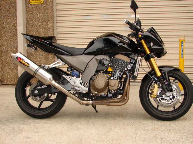

Well its finally done........ The front end project is finished ... now for that rear end!
The first ride on Friday was ....WOW what a difference, she just soaks up the bumps compared to the dreded Z pogo... & the radial brakes are fantastic after spending considerable time with the bike on the bench waiting for the new axel to be cut (original spacer measurements given did not suit) I had plenty of time to extracate every single air bubble from the brake system... running motul race spec fluid she stops on a dime..... cant wait till the pads bed in they will be even better.
