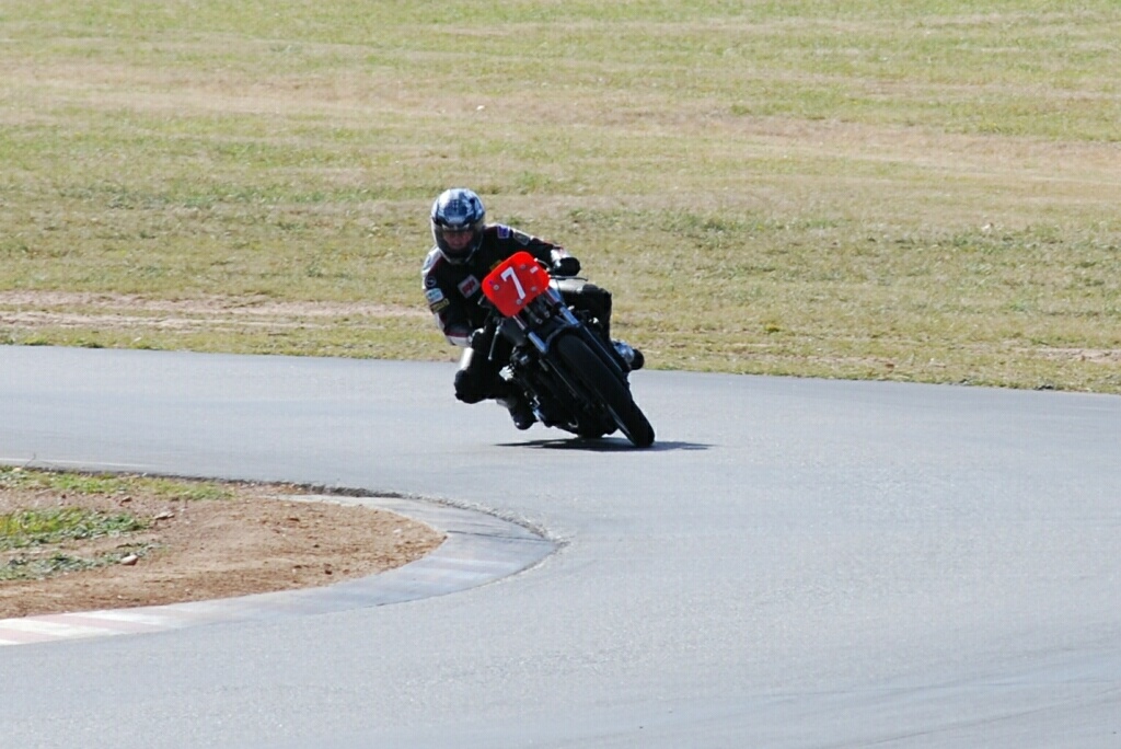

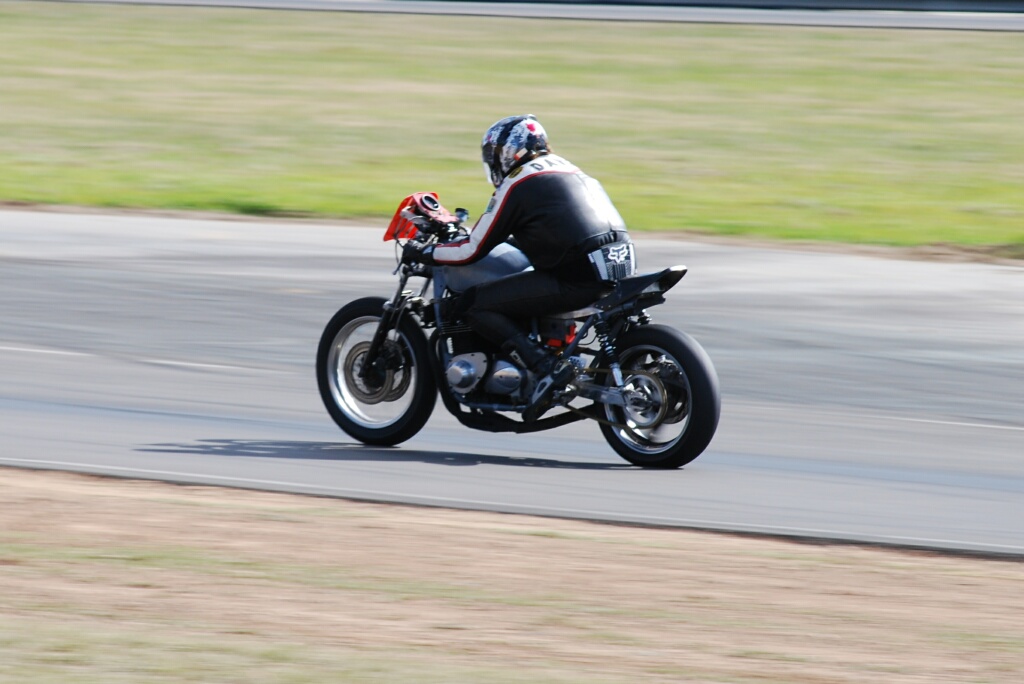

The lowrider in action
Re: Genesis Of A Racebike - IT LIVES !!!!!
loos a bit funny witht he big front wheel... lucky thats going... 8)
but nice work gos, could christen is the "toe grinder" toe cutters evil relative :twisted:
