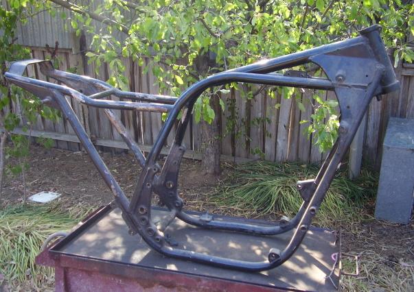

Frame - 1980 Z750. Some mods already done, all excess brackets, etc, ground off. Further mods - engine mounts to be modified to suit motor, further bracing on frame tubes.

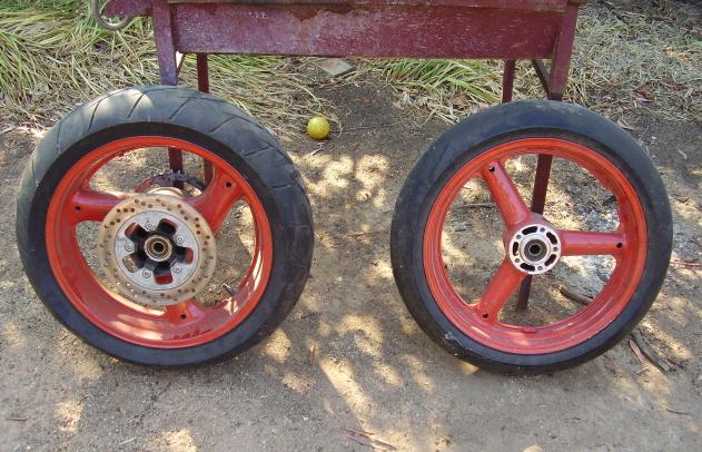

Wheels - Class-legal 3.5x17 front, 4.5x17 rear. Unsure of heritage, I *think* they are GSX-R rims from the early 90's.

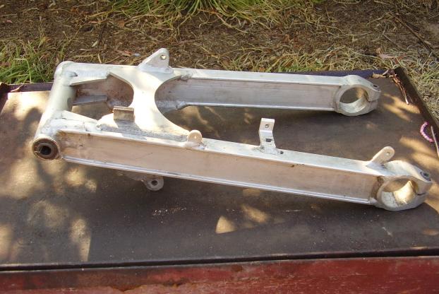

Swingarm - Box-section aluminium swingarm, modded as required.

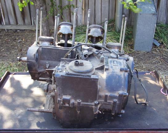

Motor - 1980 Z1000J motor - 1170cc capacity, otherwise stock ... :wink:

z750 frame, dragged out from under a bench where it has sat for the last 7 years,........
Normal 17" rims for the Unlimited Forgotten Era class. They need to be Green !!
Box-section swingarm - to Brace or not to Brace, that is the question...
Old'n'dusty.......but there's horsepower in them thar cases !!

Yes I have been a bit slack............did a proper trial engine-fit today, looking good, top front mounts line up , lower fronts will need to be moved, and rear mounts line up as well...........ya just gotta love KHI 'economies of scale'.... :lol:
Already changed the swingarm, I had forgot about the GSX1100 number floating under a bench, its a better fit and lighter as well, so its going to be used instead. Used some old shocks, fitted the rear wheel up to the s/arm to check the chain run............well I'll be buggered, it lined up straight :shock: :lol: one less problem to worry about.

iamwithstupid.gif just yell if ya need a hand & hand those rims over & i will spray em green before tire change :wink:
