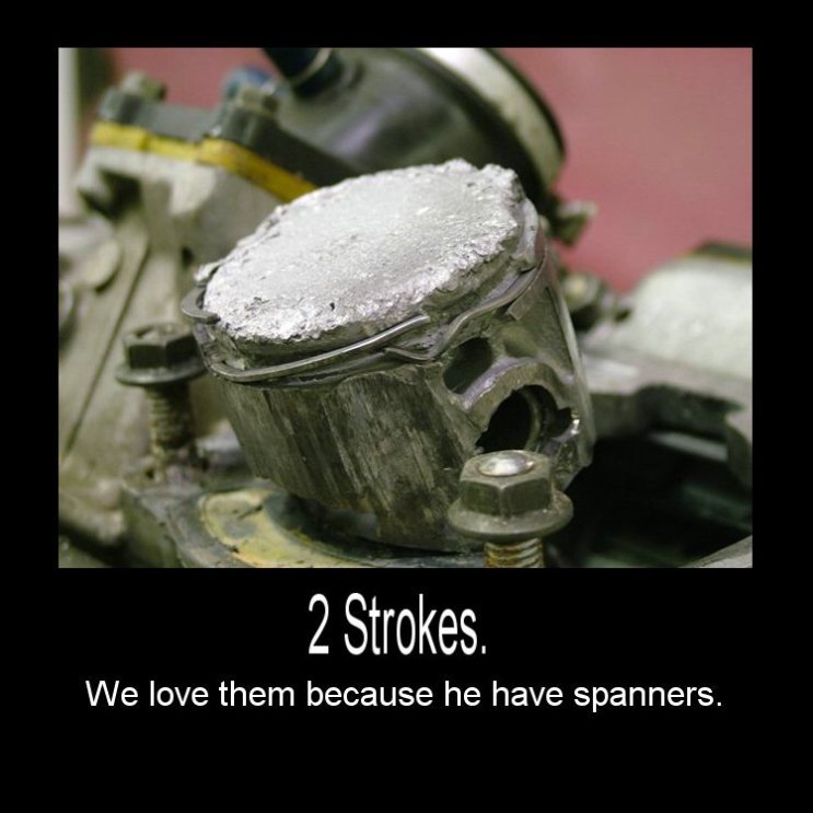

That is NOT my piston and the spelling is not mine either . Rest is true :lol:
