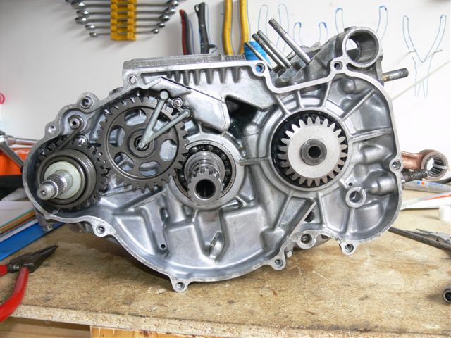

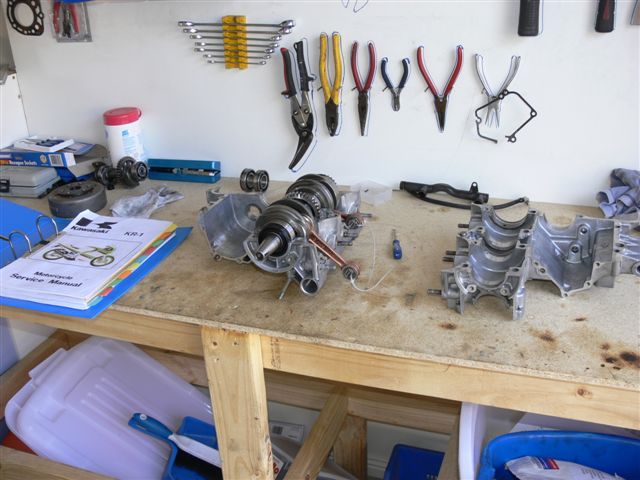

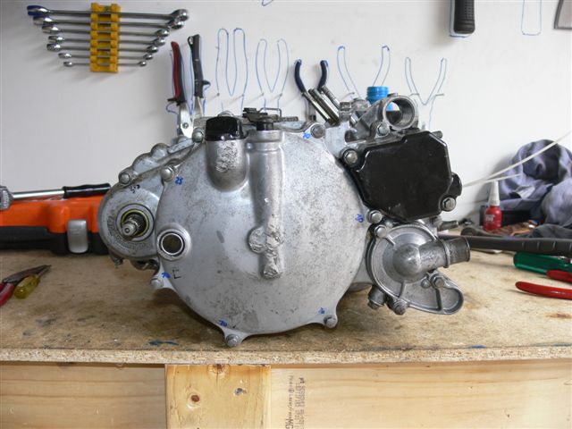

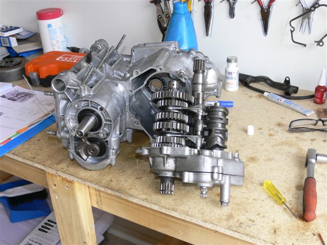

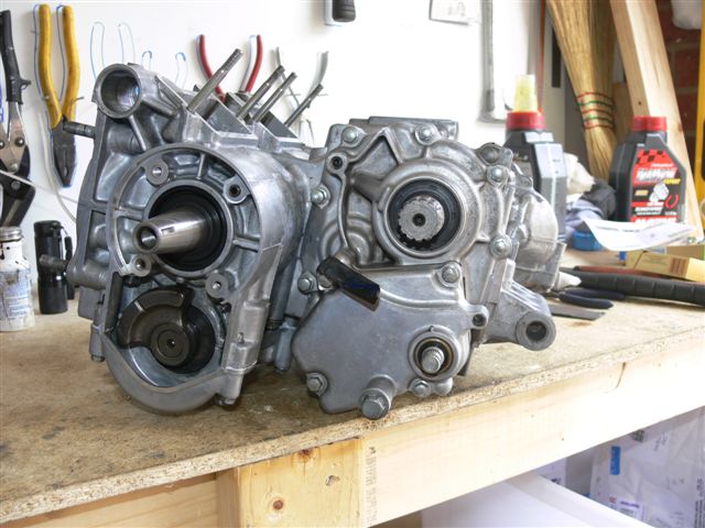

Getting there with the "Steve Austin"

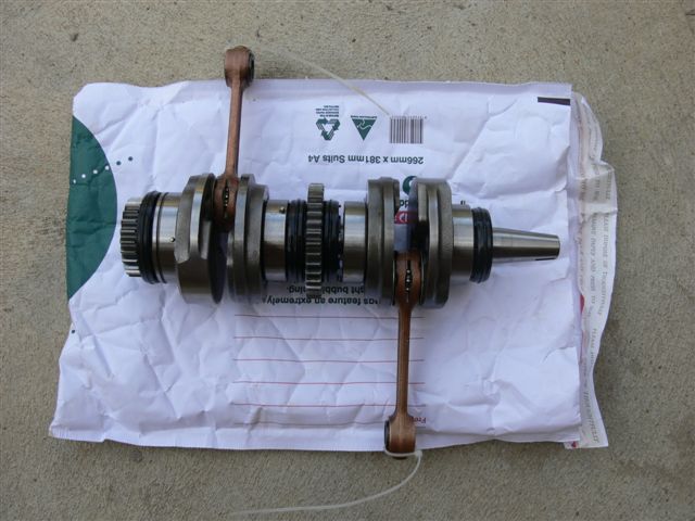

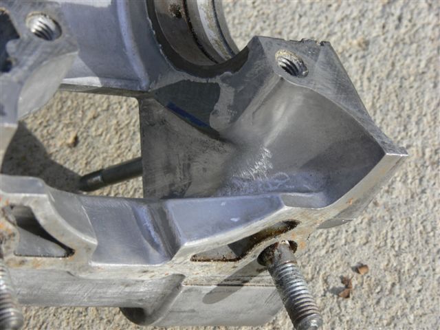

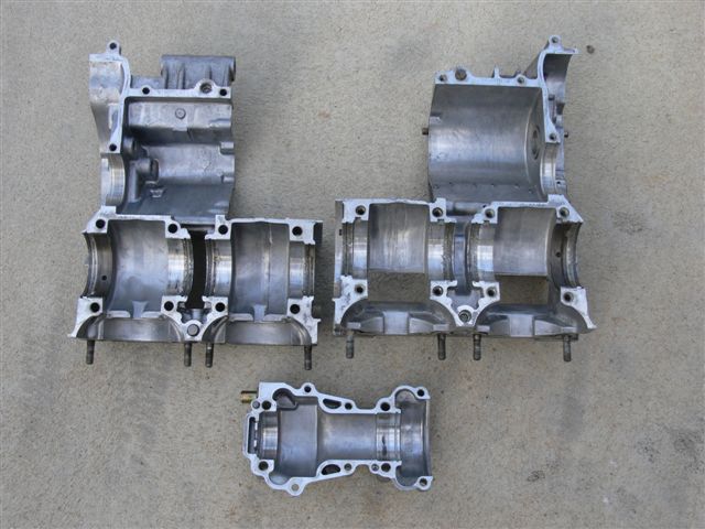

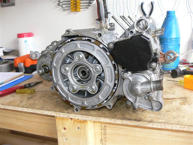

Finally got the crank back with new bearings , rods and seals , so could hook into the lower end of things last Saturday .
Have flowed the cases and had the inlet blocks shortened while waiting for the crank . Barrels still on the way , grrrrrr
A couple of build pics :D
flowing work
flowing work

Crikey Billy that bench is a lot tidier than last time I saw it.
So does this mean it's nearly ready for me to have another go on? :? :lol: :lol: :lol:

Who did the crank work Bill?

aardvark wrote:Who did the crank work Bill?
Hyside Trading , a bloke named Martin who I met at a club meeting . Seems to know his stuff , time will tell :shock: but he has a 350 LC that runs Ok and has built for others who give him the thumbs up . Knows LCs a lot better than KRs . He has no problems with mailing stuff too .

So how much did the crank work cost (roughly)? I suspect the TZR bottom end may be tired since it looks it has had standing water in it and I measured a crank bearing run out of 0.08 mm. Looks like the crankshaft got posted by normal mail to you? I was thinking there might be some crazy postage charges for sending a crankshaft.

MiG wrote:So how much did the crank work cost (roughly)? I suspect the TZR bottom end may be tired since it looks it has had standing water in it and I measured a crank bearing run out of 0.08 mm. Looks like the crankshaft got posted by normal mail to you? I was thinking there might be some crazy postage charges for sending a crankshaft.
Your engine is looking lovely.
That hyside trading website is a bit of a shocker. I don't think the member details are meant to be visible to everyone. Your name and e-mail is there.
The crank cost 725 and I supplied the oil seals from the UK . He had to supply some bits from another KR crank as one of the pins was rooted . New rods contributed a fair bit :oops:
Best to get yours rebuilt before it lets go so it will save on damage to the crank and mybe the cases . My cases took a bit of a hammering and I have had to patch a couple of hair line cracks . Postage was cheap and quick . I think it was $12 to send the crank and barrels to him . Still in Victoria so it shouldn't be too crazy . Oh , the bearing were excey too as they have locating pins and are difficult to source . Thanks for the compliment :oops:

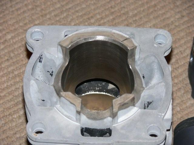

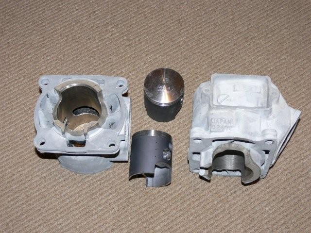

THE BARRELS ARE BACK !!!!
Drove 200k last night after work to pick these up . Time is running out to get to PI next Saturday :shock:
Will be in the garage tonight and annoying the neighbours around 11.00 :lol: (maybe :oops: )

:lol: :lol: No Problems Ardi , you would certainly enjoy this one . Have got her back together , pipes are on , just need to throw a battery and some water and fuel in and I can give it a kick .
Turning it over feels like it has a shed load of compression :D Stay tuned
