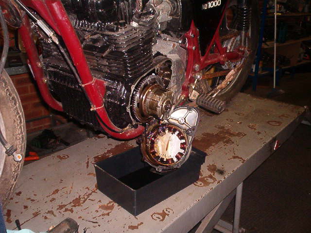

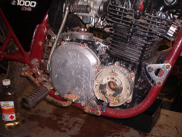

You were saying alternaters are not interchangeable.
does this tell part of a story?
- IM002794.JPG (60.28 KiB) Viewed 16832 times
- Gosling1
- Team Donut
- Posts: 13827
- Bike: ZX2R
- Location: Anarchy Road
Re: I.D. a Z1000 I just bought
igniter coils on r/h end of crank are stock for that motor, as is the rotor on the end of the crank.
My 1980 H model uses the same design rotor/alternator windings as the later J/GPz motors - a large external rotor with a smaller set of windings that are bolted to the inside of the alternator cover and sit inside the rotor....even though externally it looks basically identical to your 1980 MkII motor....
this link shows what the later style rotor/alternator looks like.
Eastoe
- Posts: 102
- Joined: Fri Feb 10, 2006 6:11 pm
- Bike: GPz750
- Location: Casula NSW
So does that mean I have the correct alternater for a MKII engine or is this the early alternater?
Got me worried when you mentioned different sprockets on different cranks and cams.
I figure Electronic ignition indicates MKII engine. I just hope it's not a mix of the 2.
A mate seached the engine number on another site and thought it came up as a 77 or 78.
I'll check to see if the engine number is different to the number I listed initially.
- Gosling1
- Team Donut
- Posts: 13827
- Bike: ZX2R
its the correct alternator for a MkII motor mate. I initially thought that the MkII rotors were the same as my H (1980) - but they are not. The H motor - while externally almost identical to the MkII motor - shares a few more parts with the J/GPz motor than I thought. The valve sizes for example - are the same as the GPz1100. The rotor/alternator is the same as the J and GPz motors. Cam chain and cam specs however - are the same as a MkII.
To really make sure - rip that cam cover off, and count the teeth on the cam sprockets. You want to see 16 not 15 !
