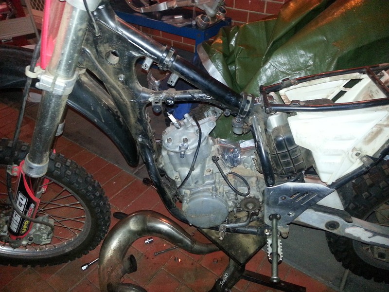

The donor, after a while it becomes easy to part it out for the conversion. It is plain to see the old slowly becoming very old as this progresses.

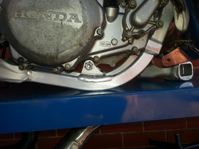

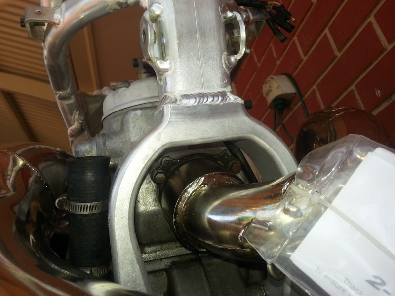

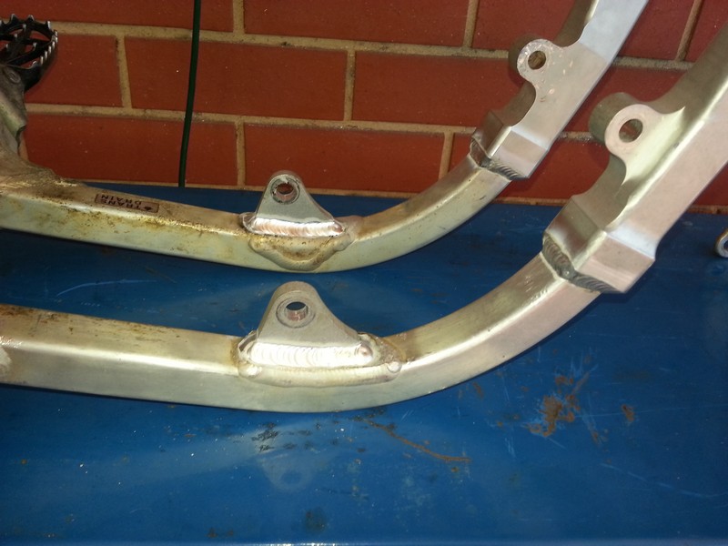

A mate did a fantastic job welding the frame, once it is all cleaned up it should look like factory. 8)

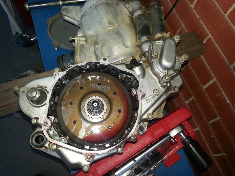

Finally got the cometic head gasket so the new head is now torqued down.
New clutch basket and fibres are here, springs and steels all within spec.
Waiting on clutch basket holding tool so i can torque that down properly and do a quick soda blast to tidy the up the appearance of the barrel before fitting it into the frame.
hinson basket and new fibres.jpg (155.48 KiB) Viewed 30806 times

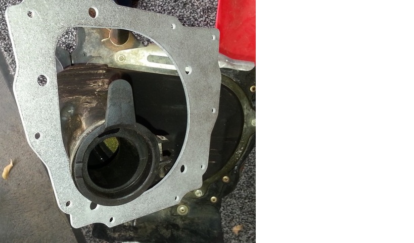

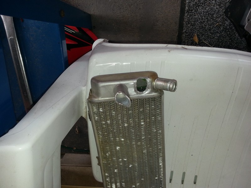

next... Align the exhaust for welding hanger brackets, weld coil bracket, make an adapter plate to mount a CR250 airboot to the CRF airbox, modify radiator outlets then re-assemble the bike.

Sloppy welds. Hope you didn't pay the rogue who did them too much!

Looks most excellent . Those welds are sweet !
Re: CR500 Steel to Alloy frame conversion.
Posted: Sun Mar 03, 2013 9:50 am
by timmyrocks
Nice ;) welds look sweet :)

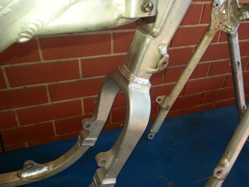

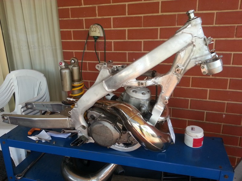

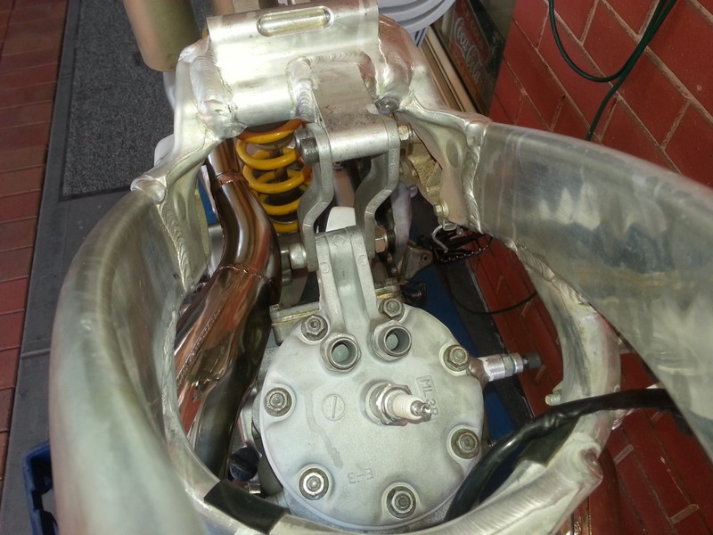

looks sweeter after an acid wash
(except for my grubby mits touching it)
Before
After
Heaps of space

What is the wash you used ??
Posted: Sun Mar 10, 2013 9:34 pm
by Jonno
the kid wrote:Nice
Ali Brite (Septone)
Works great.

I am waiting on parts delivery again, particularly a CR250 air boot wich matches up perfectly with an adapter plate to the airbox/carb.
All the brackets for coil, exhaust etc and radiator mod done ready for welding

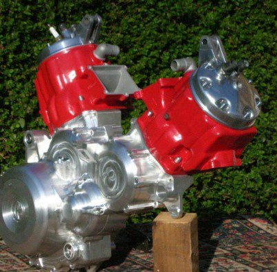

I found this, could do the job.
1000cc twin.jpg (50.11 KiB) Viewed 30739 times

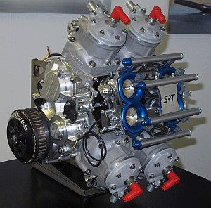

Yeah but thats not big enough, maybe this would be better. :twisted:
inj V4.png (177.02 KiB) Viewed 30739 times
i cant remember if these are 500cc or 700cc mugen barrels.
