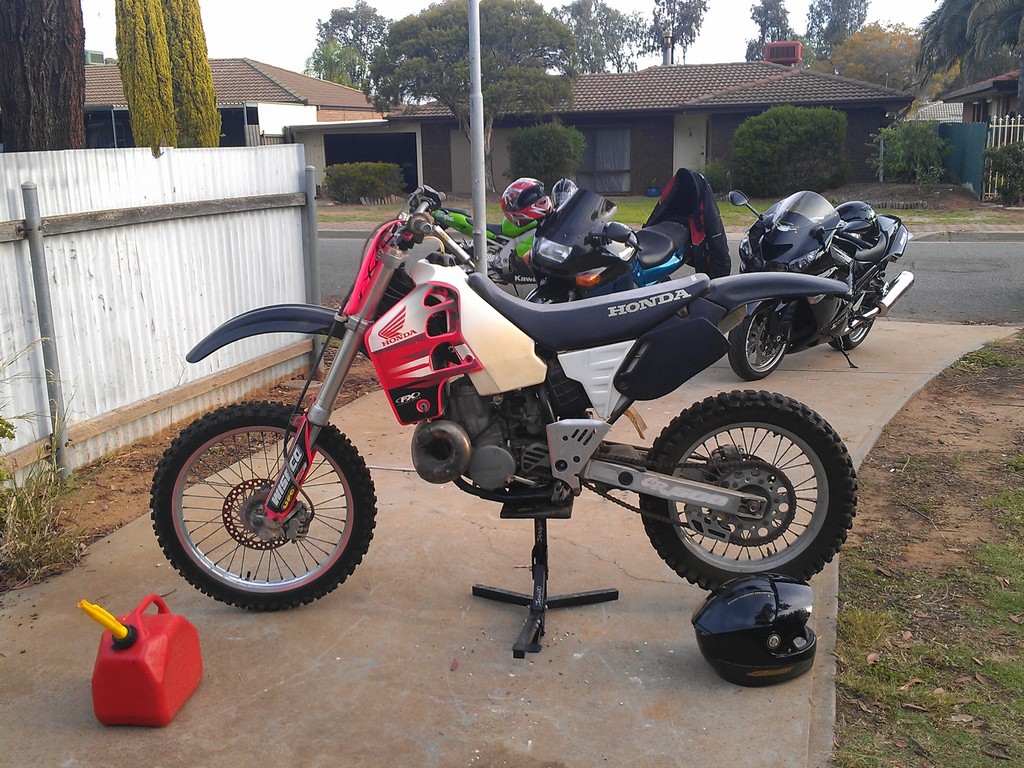

1994 CR500 complete steel frame bike with engine. .
Big thanks to Laidback for picking this up in Batemans Bay and transporting it to Adelaide, awesome mate :kuda:

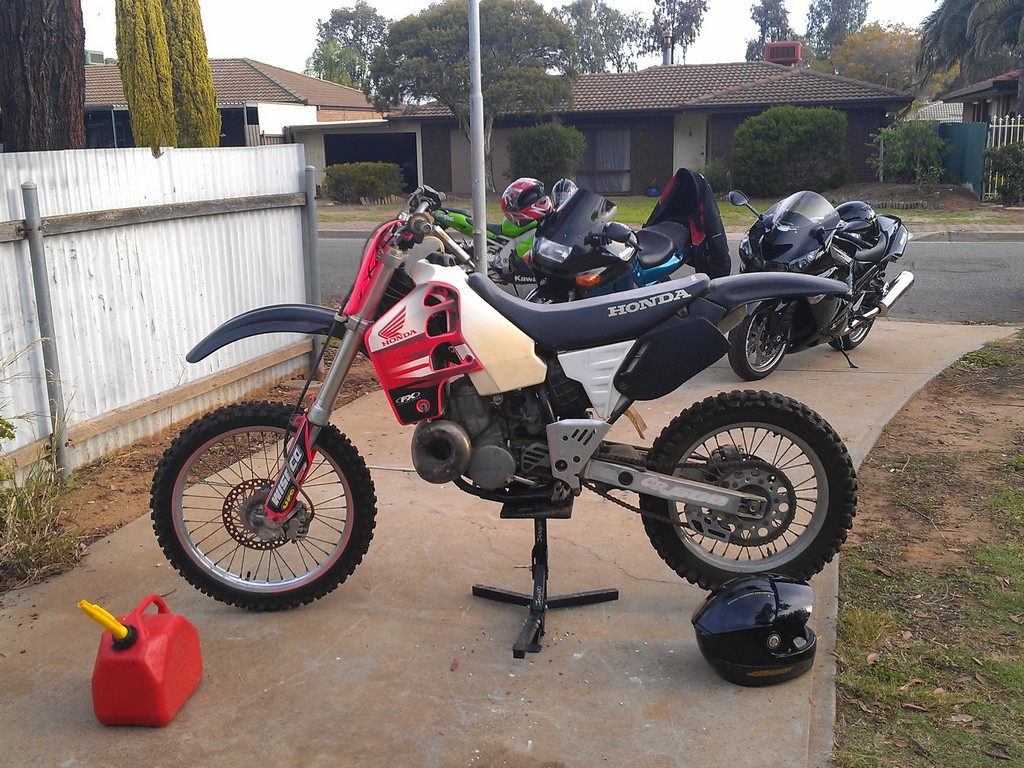

The above photo is when it first rolled out of Johns van, it wouldn't fire straight up so we drained the fuel as it hadn't been started for over a year but the carb bowl was pretty clean, all i had was outboard oil so a mix of 30:1 was used to get some lube into the crank bearings etc.
After a few kicks she fired into life in a window rattling fashion and a big plume of smoke, had a quick spin up and back in the street by which time every neighbour was either standing out front or peering through their window :lol:
I put it away quickly before the emergency services were called for what could have easily been mistaken as a small plane crash :lol:
Upon closer inspection the frame had indeed been re- welded as the previous owner had stated hence the cheap purchase price (more on this later), it would need lots of TLC having being neglected for some time, swingarm and rear wheel bearings were completely shot which isn't unusual for a CR500. But hey I didnt care about the frame at this point as the plan always was to transplant the donk into an alloy frame.

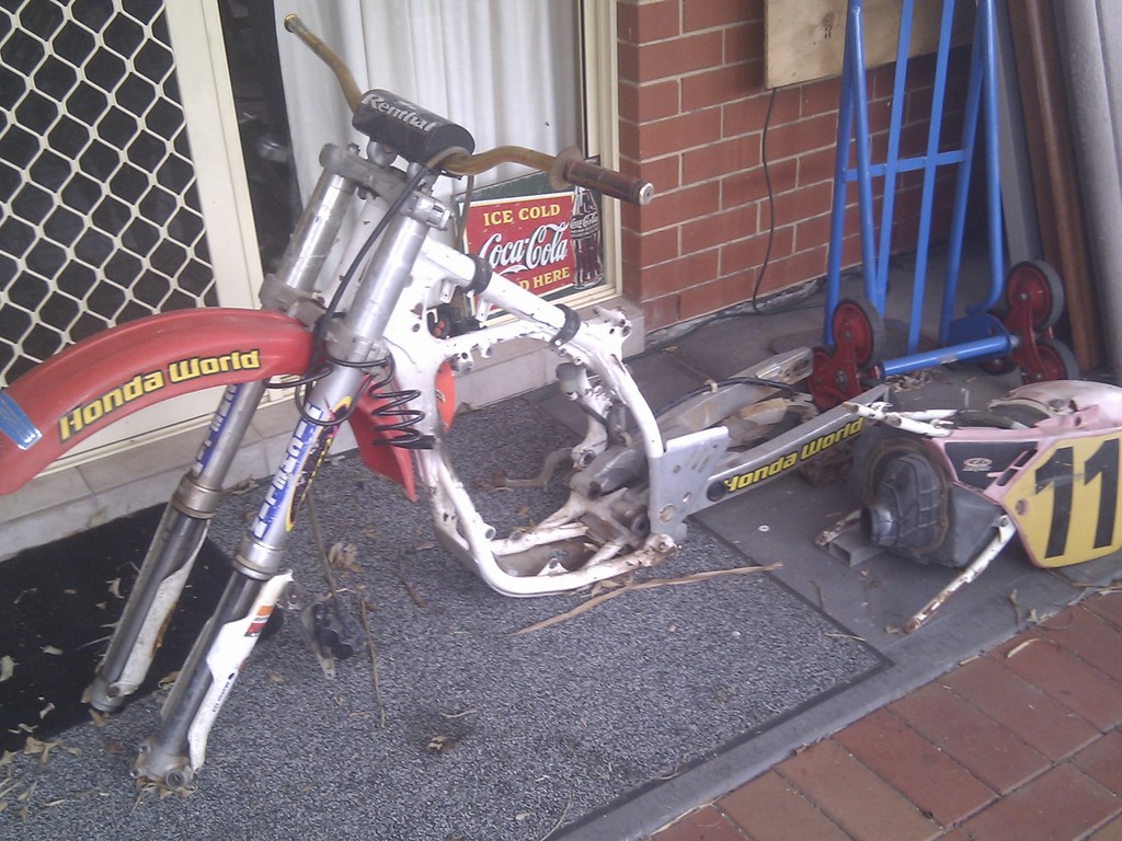

Possum put me in contact with her dad Hank who is great bloke with lots of interesting stories and his help was mucho appreciated, he had found a CRF250 - 2007 with blown motor, when I picked it up he had a buyer for the motor so I re-couped $200, I could have got more but hey might as well offload it or I will be stuck with it :D

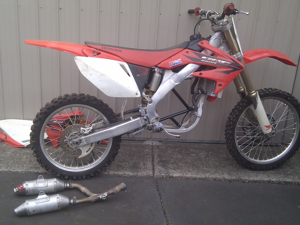

2007 CRF250 alloy roller minus engine. ( cr5 engine jig sitting in the frame)
CR5 frames2.jpg (218.48 KiB) Viewed 171447 times
The plastics are a bit scuffed however being a Honda there are plenty of replacement parts and decals for this model.
This frame will save about 7+ kgs on overall weight, better chassis geometry, modern suspension and brakes.

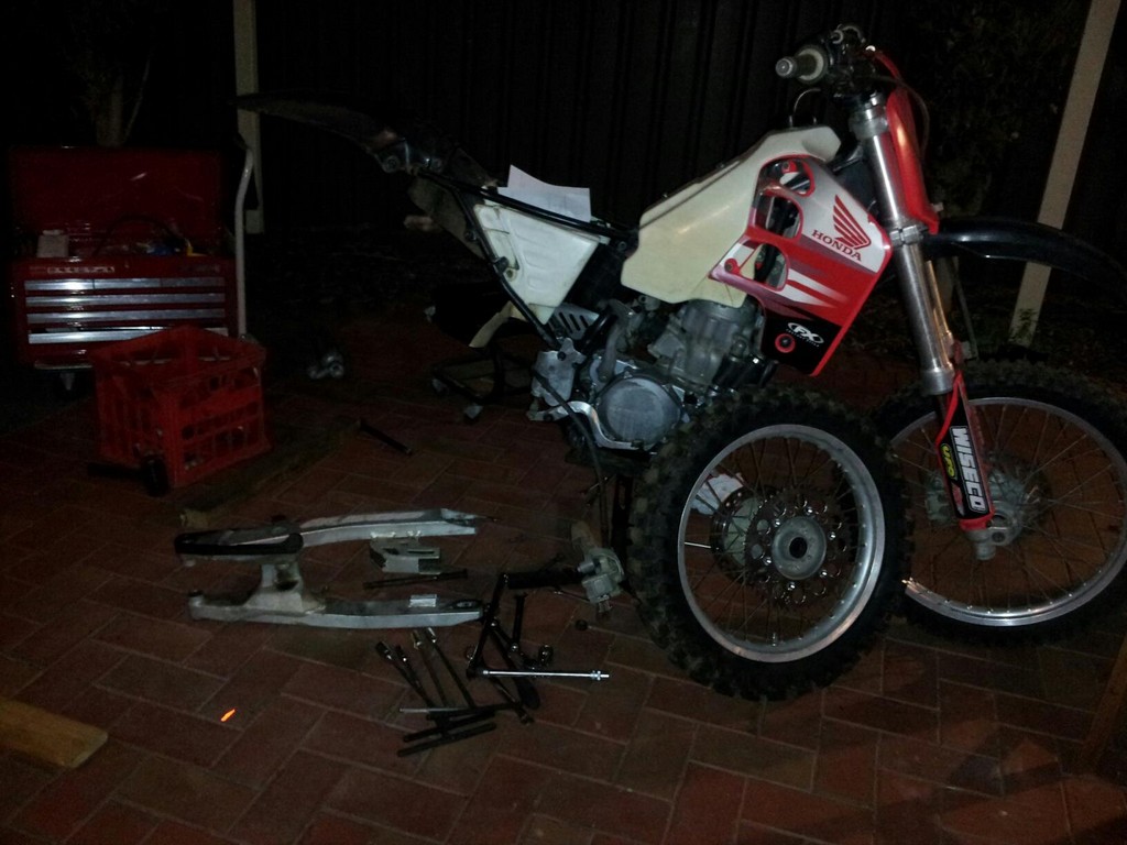

This is about where I am at with the project at the moment.

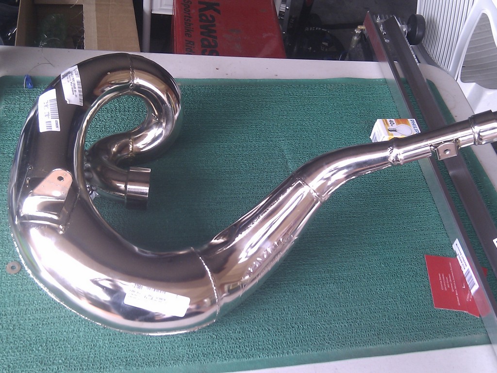

The exhaust was cracked from a few dings, the flange was leaking and misaligned slightly, replaced "o" rings and tension springs using high temp sealant and did a dodgy weld repair on the pipe and it did the job for now.
So the best thing to do was to buy a new pipe for the conversion, same as the old pipe designed for torque. Nice and shiny, no dents, so tempting to install it..
CR5 FMF Gnarly1.jpg (229.78 KiB) Viewed 171447 times
Shock was re-built because it was rooted, FMF powercore2 muffler re-packed and a few $$$ spent on Honda genuine parts so in the end it wasn't a quick cheap band-aid fix but it was worth it just for the ride :twisted:

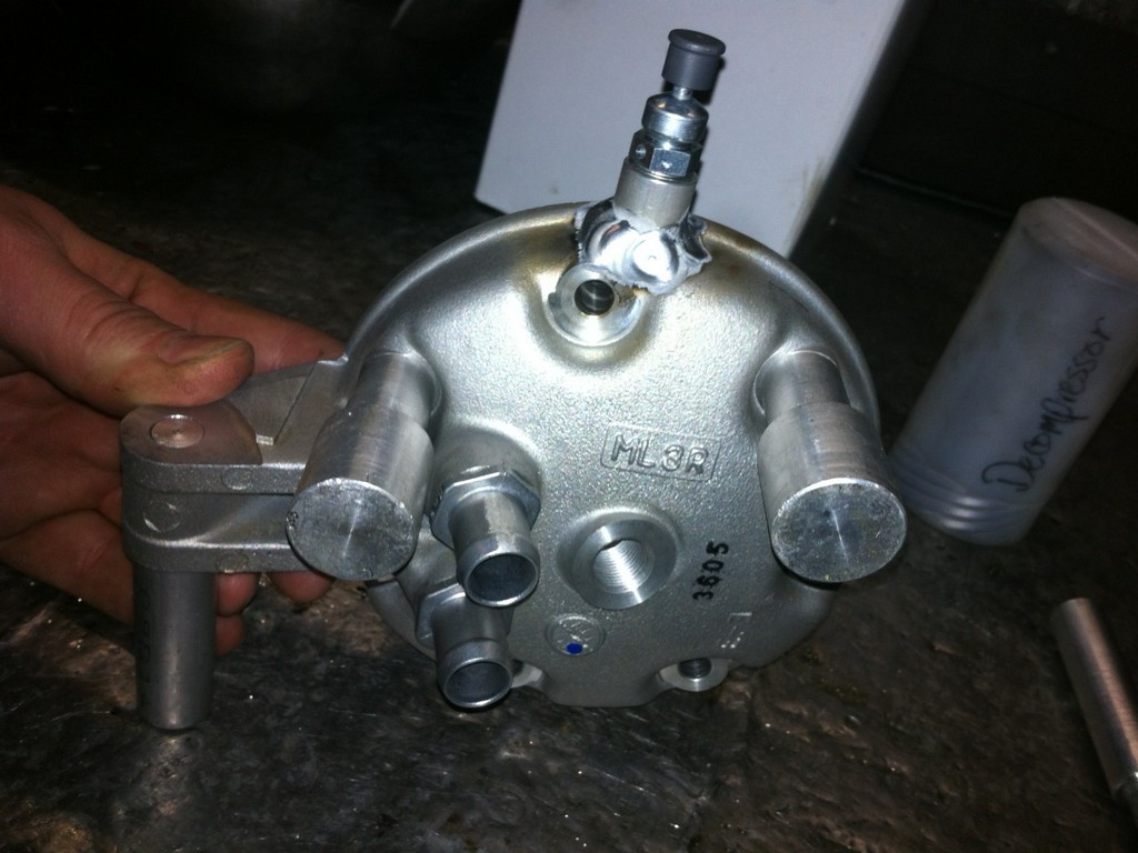

I have a modified head from Canada from a respected engine builder.
CR5 hi-comp head with decompression valve. Cant wait to get this installed :D
CR% heads1.jpg (137.84 KiB) Viewed 171447 times

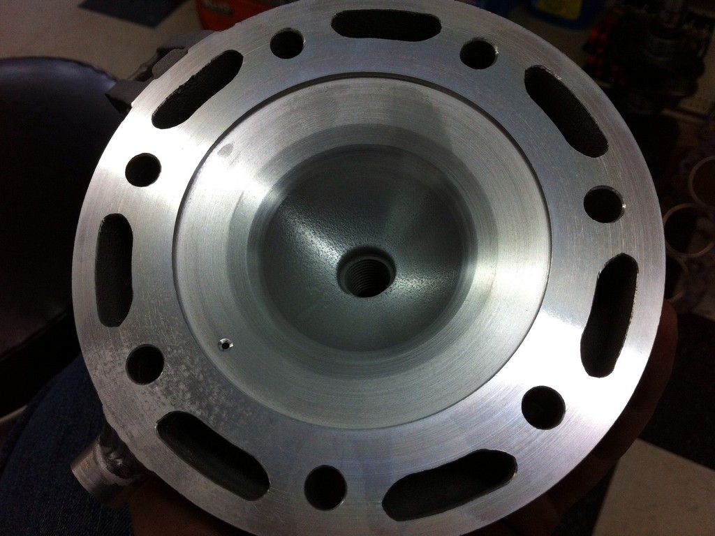

Squish mod.
CR% heads2.jpg (153.22 KiB) Viewed 171447 times
You might ask why a decompression valve? Why not! Less pressure on kick starter casing and much easier to start for us ol'kharns.

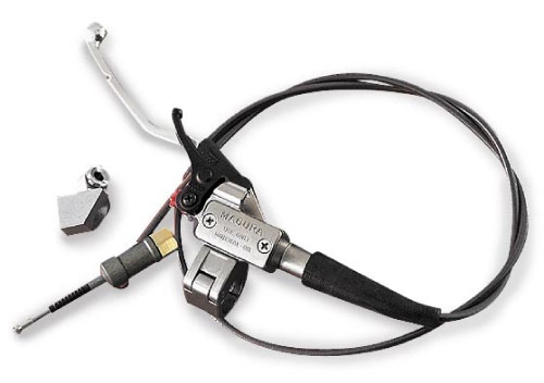

Another good mod is to install a hydraulic clutch lever kit which helps a great deal in the tighter trails.
Magura hyd clutch kit. (Simular to mine.)

Bty that head is running .06mm squish? or .07mm cause that will make it peakier :lol: :roll:
if that was running .06mm or .07mm squish it would last about 2 seconds.
