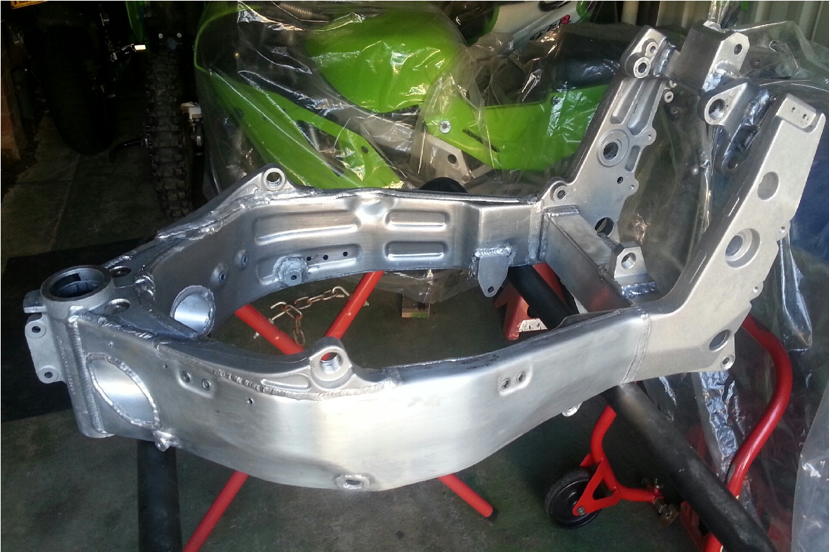

Day off today so I got busy, the frame had had a few coats of black paint where it had been touched up in a few different places. It gave me a good excuse to strip it back a check for cracks, all good with only a few scratches to sand back. The swingarm goes off tomorrow to get mounts welded on for race bobbins then it will get the same treatment. Going to go with a black 2k base coat with a 2k flat clear only because it was the best I could do in 2k. No real semi gloss black in 2k, it will be interesting to see how the finish looks on the frame.

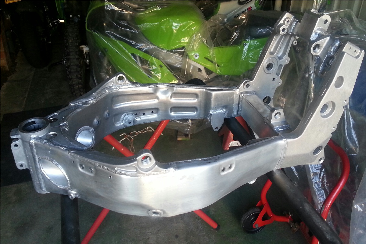

You don't muck around do you Rob. What did you use to strip the paint off? Whatever it was worked a treat.
Who are you going to get to weld the mounts on to the swingarm for you?

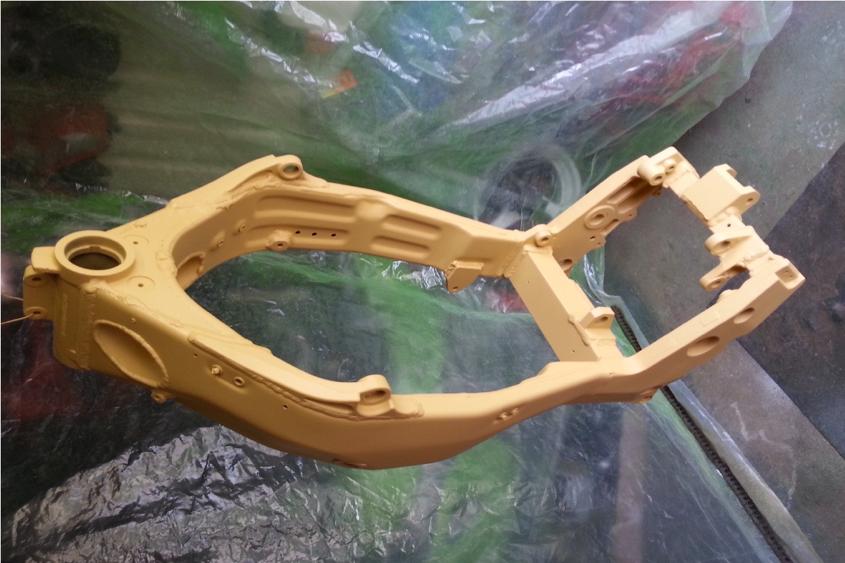

Kev, I only used about a 1 ltr of paint stripper, soft brass brush and a med scotch brite cleaned up very easy. Only money poor not time poor
. I can't remember the name the person who does some of my alloy work, but he's over near bankstown airport. I had a few things come up today so I coundn't get over to him, doesn't really matter as I didn't have time to turn up the mounts for him to weld on.

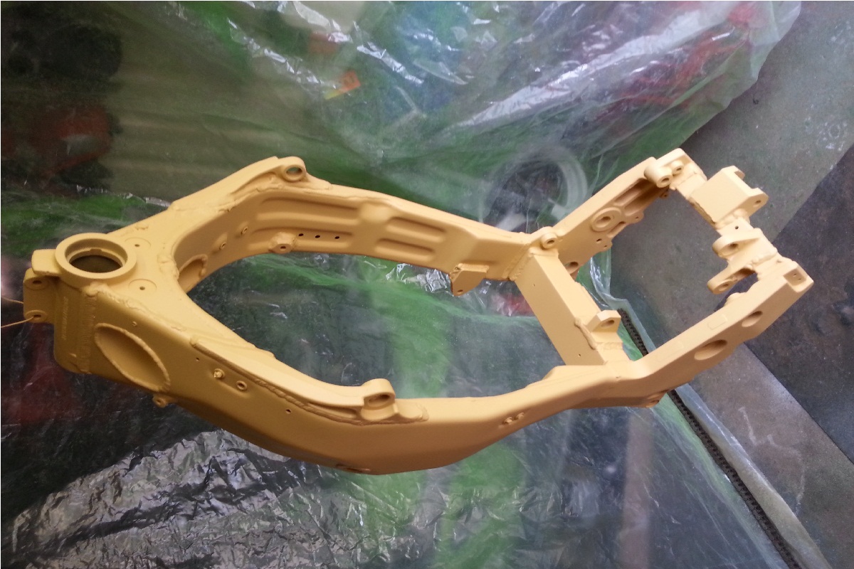

But I did get time to put the frame in etch primer and sand blast the header pipes , link pipe & give a coat of paint.

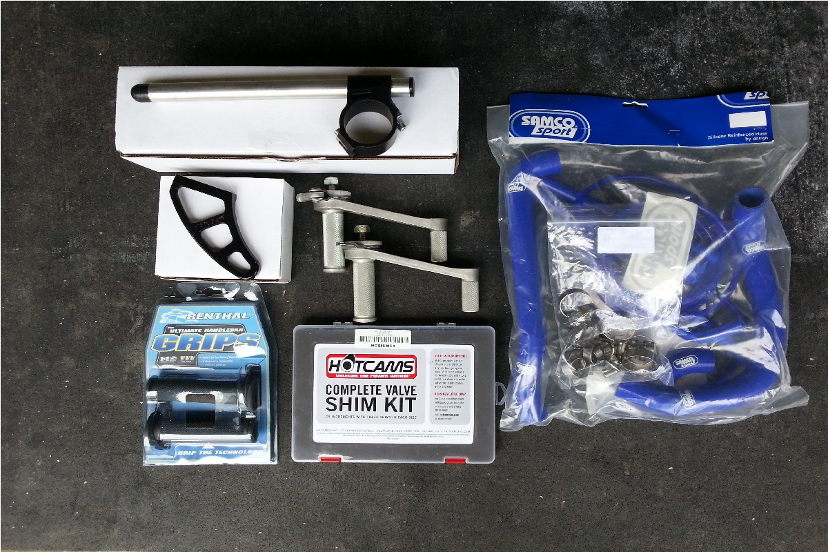

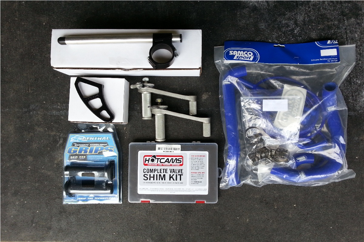

He's a picture of the frame in etch primer and some parts that have come over the last few days. Love the sound of the delivery man banging on the door of a morning. My woodcraft clip on's, toe guard, samco hose set,stainless steel clamps, shim kit & tarozzi rearsets.

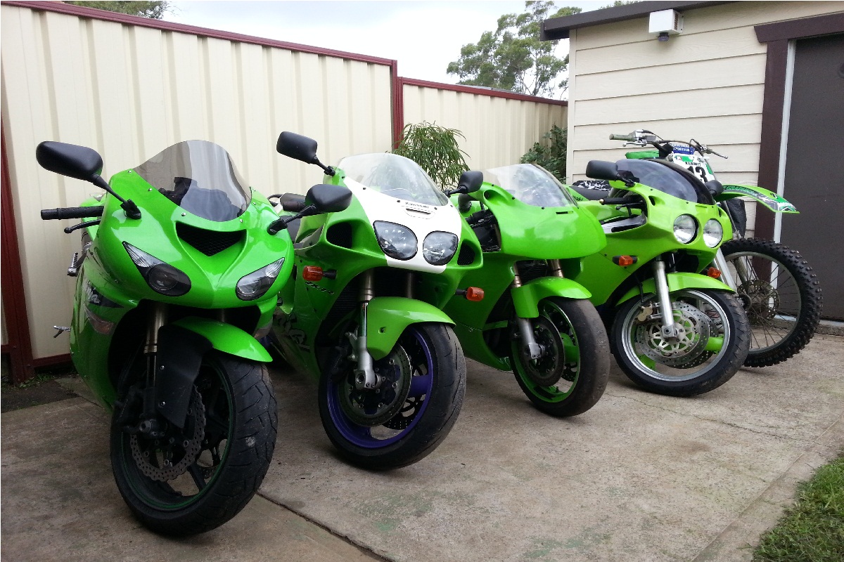

Here's some of my collection thats green for you.

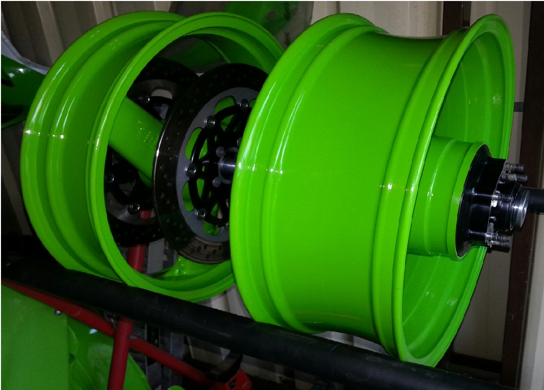

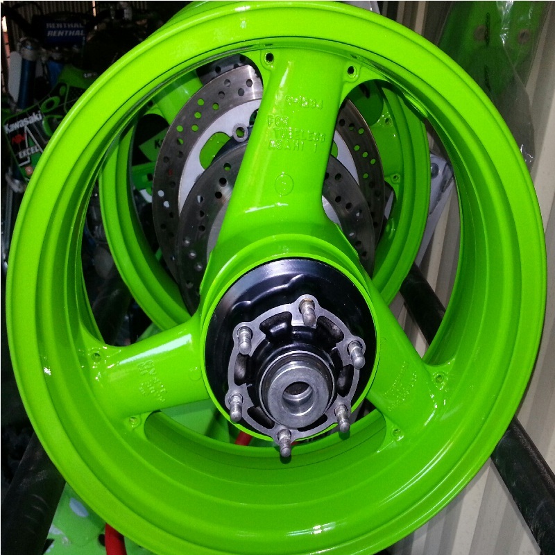

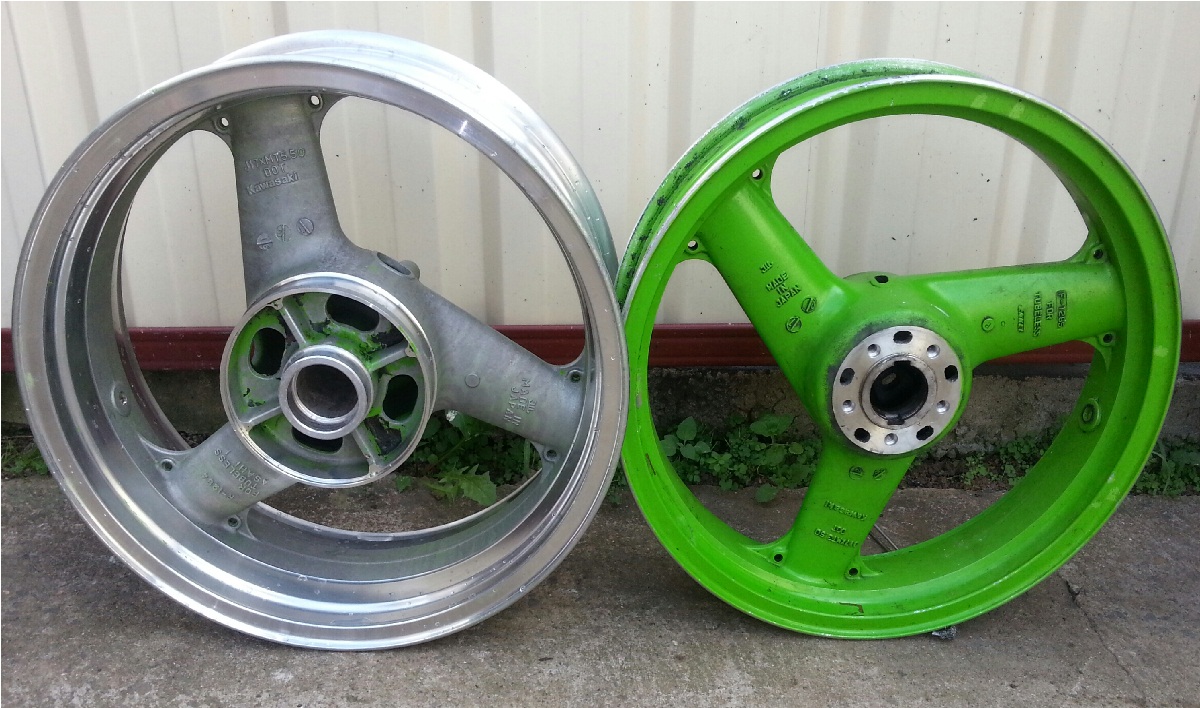

While I've had some time over the last week I got the green paint mixed up started repairing the fairings and painted the wheels. The mix I got made up is more closer to the P model green not so yellow as the earlier green I like it better anyway.
The wheels came out nice, new bearings and axles rezinced for the hell of it. Front forks have been disassemble, cleaned and checked with new fork seals and oil was all that was needed.At some time it has had new bushes by the look of it as there is no play or wear at all.
Still waiting for new steering head bearings to arrive so I can start putting the frame back together and get it rolling again.
