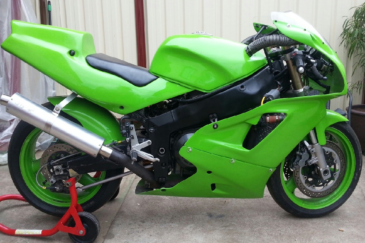

Looked what arrived today. Going to be a busy weekend going through the bike.It was a ebay purchase & has a lot of goodies on it, kitted forks, ohilns rear, carbon pressurized air box intake under steering head intake, cr flatslides, head work & cams. Once sorted and race licence gained hopefully i will be able to get another greenmeanie out there. Any suggestions on what type of slicks & most common sprockets needed that are being used would be apprecitated.

Not sure a out the gearing on this model but I went -1 on the front and it feels perfect at EC!
Nice looking bike; hadn't spotted that on eBay!

Nice pick up
Good price too.

She would be fairly happy with 16-42 or thereabouts But if you have lots of spares, have a play and see what feels best.

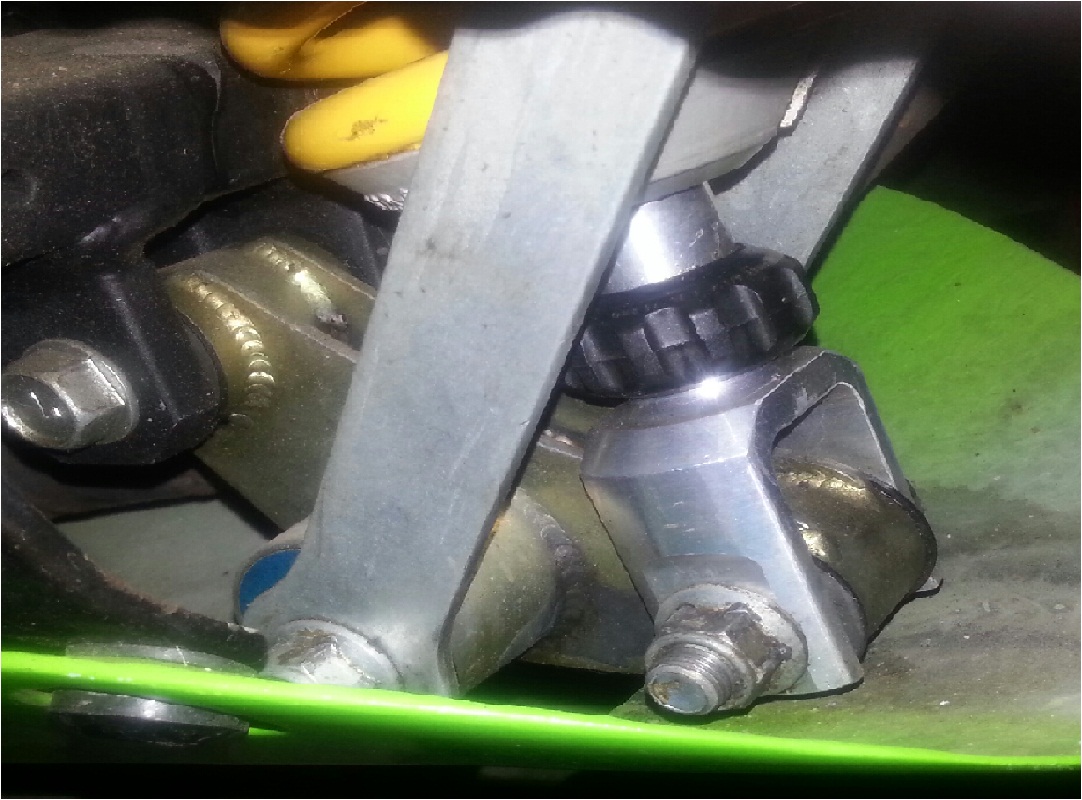

Here's a picture of the rocker arm setup, can anyone shed any light on make.I know that the H would benefits due to the rear end being hard was this a case for the J aswell. When through the carbies last night at worrk pretty good condition, found the air screw wound right in, maybe thats why the previous owner couldn't get the bike to run properly under 3k.

You'll have a ball racing with the PCRA, they're a great club and almost everyone goes out of their way to help you.hipstir70 wrote:Here's a picture of the rocker arm setup, can anyone shed any light on make.I know that the H would benefits due to the rear end being hard was this a case for the J aswell. When through the carbies last night at worrk pretty good condition, found the air screw wound right in, maybe thats why the previous owner couldn't get the bike to run properly under 3k.
That is definitely an aftermarket link but as to the make, it’s hard to say unless you can find some sort of markings stamped on there somewhere. From the welds and colour in the picture it looks like it’s made from mild steel and has been zinc plated rather than made from aluminium. The dog bones don’t look like OEM either. Good to hear you might have solved the low revs problem.
I know this is probably a huge ask, but is there any chance I can get the measurements of that linkage so I can make my own for my H2 to solve the rear problems they suffer from? I’ve been trying to source some info/dimensions on aftermarket linkages and suspension upgrades for ages without any luck.

hipstir come and say hello my bike is a h1 number 94 black and green .kev i will bring a p model linkage with me to see the diffrence there isnt much room for a change in linkage with the p model the shock hits on the hight adjuster put longger dog bones in and the rear is to low put the shorter ones in and the shock hits ????

Kev, that will be no trouble at all. You just want center to center on the dog bones? I'have a look tomorrow for you and pm you. If your after the shock linkage spec i'll be removing it and the swing to regrease very shorty.
Cheers Rob.
