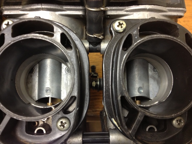

Pics of the tubes that protude, 3 are short & the end one is a couple of mm longer, another strange thing.
Are they removable & different sizes, If its an odd one can they be made the same & which ones are right ?
Someone's had a party with this.
Can't attach the bloody pics.
Re: 94 zxr750 Won't rev
Posted: Thu May 16, 2013 7:10 pm
by willrcr15

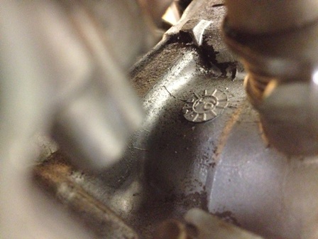

Well looks like a big problem, 3 of the carbies are dated 1989 & the odd one is 1994, it happened to be the one with the correct needle but they all had the wrong jets.
Maybe there's someone out there with 3 dated 94 & 1 dated 89. How the hell did this happen, aliens, sabotage, got me.
So looks like I need 3 carbies at least.
Has anyone out there got anything ?
Ningainoz has been very helpful, hope youve got some spare carbies laying around.
Maybe there's a set cast aside off a tracky.
