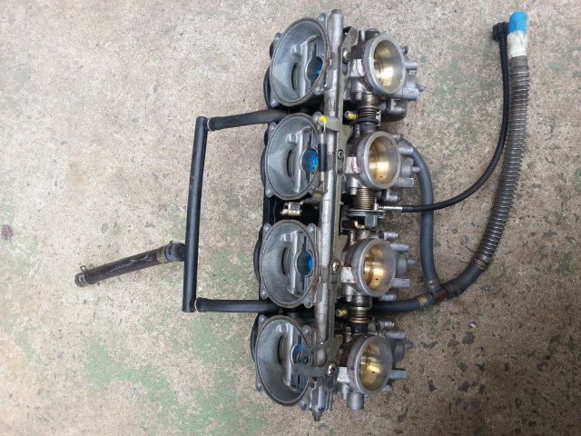

hipstir70

Re: 94 zxr750 Won't rev
Mitchell, i don't if it's the same with the 94 as the 96 but when you took off the anti pollution crap there's two lines that run between no's 1,2 and3,4 from the carburators to the air box do you still have these connected? They need this to balance airbox float bowl pressure. Hope it's simple

hipstir70
Mitchell, i have some 96 carbs check photo out to see the hoses I'm talking about.
Cheers Rob.

hipstir70
Mitchell, can you see the hoses that come from the top these carbuators are the ones needed to run to airbox.
Cheers Rob.

- willrcr15
- Warming up
- Posts: 72
- Joined: Tue Nov 13, 2012 8:49 am
- Bike: ZXR750
- Location: Newcastle
Looks like the same sort of thing.
There must be some suction through the vent tube to all the bowls from the airbox for what reason i dont know. The tube on mine is a single tapered tube, i guess the taper keeps the pressure the same along the line. But doesnt the plenum/air box pressureize ? Anywai ill connect the hose up tonight & try it
hipstir70 wrote:Mitchell, can you see the hoses that come from the top these carbuators are the ones needed to run to airbox.
Cheers Rob.
+1, I put upper engine cleaner through that hose and it feeds straight down the carbs into the engine, and if I didn't keep the revs up, the bike would slowly cut out like it's run out of fuel, and would rev like shit. I had exactly the same problem you have. I realised I had connected that to the airbox, but connected it to the little knob for it which has no hole for it to breathe! (There are two knobs right next to each other and I was in a hurry.. DOH)
That caused the problems you're talking about. They're vacuum lines.
Thanks Rob,
The mysterious world of carbies is something special ! No point trying to understand them just accept the outcome & ask no questions.
I'll try re connecting the vent / vacuum tubes, maybe tonight, couldn't do it last night, bloody work getting in the way again.
Are there any other aftermarket bolt on carbies for my model considering it's for weekend road riding pleasure
