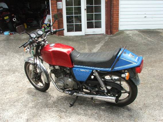

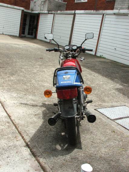

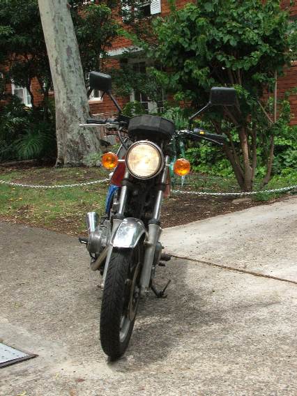

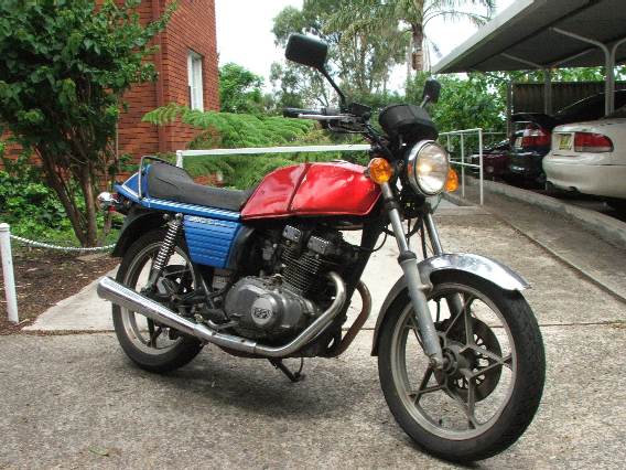

Here we go, here's the spare tank on the beastie out in the sunlight. The Original (and slightly rusty inside & out) tank will be cleaned up in due course and resprayed along with the bodywork, perhaps i'll get all the cherry red spares redone to the OEM colours.
Clutch, chain and bars adjusted, still need a couple of tweaks done, perhaps move the bars a bit further forward again to move the mirrors further forward and make the reach a bit further out. One thing i totally admit is i forgot how you need to roll the throttle over twice as much to get 1/4 the power of a litre bike. There'll be some getting used to, but all in all she felt pretty solid to ride.
Front on
Front on
Left side
Left side
Rear on.
Rear on.
Right side.
Right side.

looks alright mate, will look better with the paint done.. and those ebay indicators seem to suit the bike nicely..
plus as far as we can tell you're still walking, talking, breathing .. so you must have done well avoiding the missus.

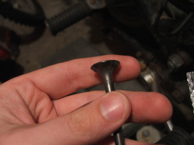

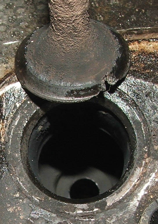

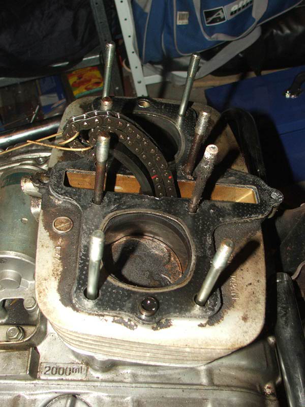

Would you believe bike progress continues. After much time doing other things non bike related, track readying the 900 and avoiding taking the GSX apart that "last" bit (i.e. head and extras off) i finally pulled the finger out, got a set of rings and and the right sized valve spring compression tool and could be arsed taking the head off the bike. What do i find? well a nice 3x3mm chunk missing from one of the exhaust valve :shock: , which would certainly explain the poor engine compression & performance (actually it's amazing that the bloody thing started at ALL!). A new valve has been ordered (would you believe the one cost me $54!) and will be fitted asap.
In the meantime i think i'll take the barrels off shortly, re-hone them, replace the rings (hey i bought them, why not use 'em?) and get the current valve seats reground and see if i need to replace any other valves, which im hoping i won't need to, but nothing would surprise me at this stage.

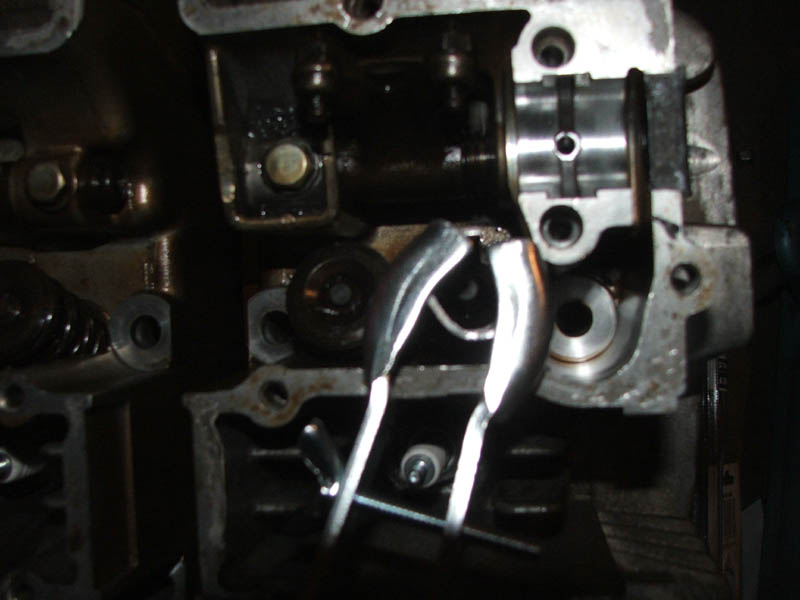

For posterity's sake, here's the pics of the shot valve i managed to extract and take pics of tonight!!

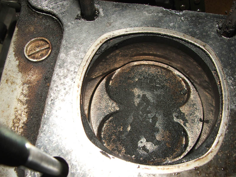

Lordy me this thing seriously is a mess. Fortunately the valve seats seem relatively unscathed, just covered in a lot of carbon, and some of the oil from the tray i've been keeping the head in. Bores actually do look like they're in very good nick, so i may just replace the rings without redoing a hone, or i might, depends if i can be arsed or not (and if i find out how to do a good hone correctly)
Check out that valve, how it was still getting 125psi i have NO fricking clue.
G-clamp based extractor plus home made spacer to allow access to remove the collet's so the valve could actually be removed.

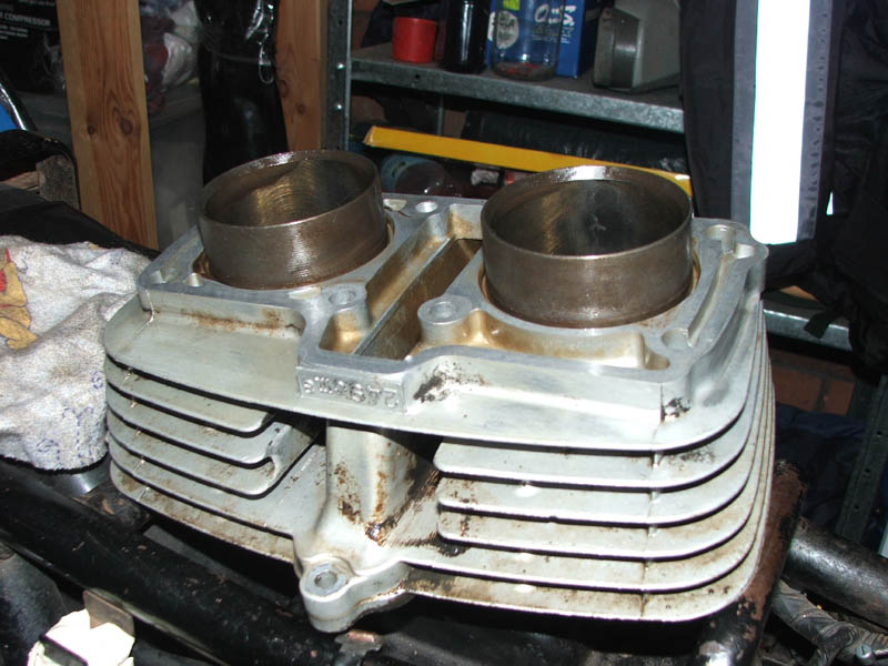

bore actually looks pretty good.
A look at the mess from a bit further out.
Got a bit of work ahead of me before this sucker is going in.

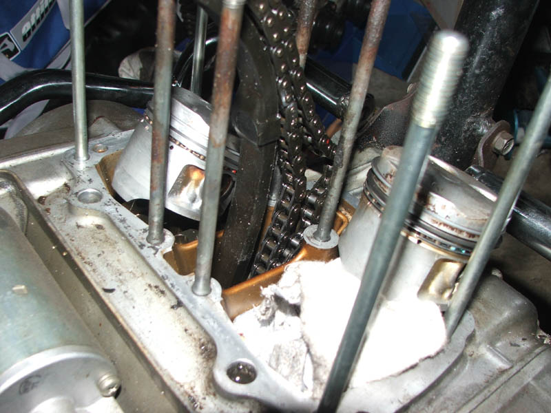

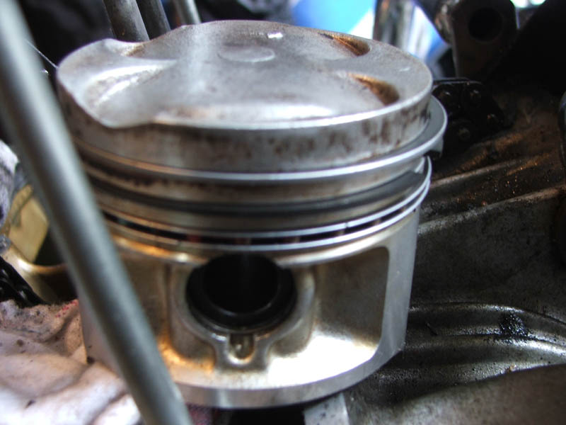

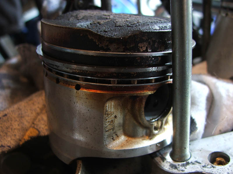

The pistons & barrels are almost done, Barrels need a good scrubdown which i'll give them tomorrow morning before they get a light hone and i start on lapping the valve seats.
Before (eww!) (l/h piston)
after (r/h piston)
after (r/h piston)
Barrel are mostly there, still needs a good once over though.
gettin' back together.
