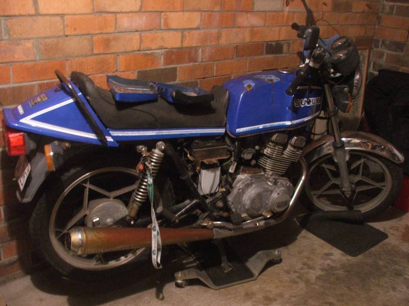

Ok here's a picture i took tonight, didn't work too well in the dark so i just tried to take one without the flash and it turned out half alright.
things on the todo list thus far,
1) forks need to sus the chrome on them out, could be a rechrome job in there if im not careful, at the least i'll check the seals out.
2) tank, shall get a kreeming on the inside as a preventative and cut back and repainted, and original decals replicated as best i can.
3) lube lube lube, so many of the hinges and swingy bits barely do, nearly tripped over putting the sidestand down as its so hard to move it.
4) strip carby's back and redo 'em
5) new mufflers, the headers are fine, the cannisters have seen better days
6) new battery, the thing probably lost half its acid in the guys tray on the way here as the fugger fell over in the back of his ute!! (no damage, to the gsx at least)
7) lots of tlc to get rid of all that oxidisation on the engine and wheels
8) electricals once over
9) oh and i forgot, overhaul the brakes, this thing has NO FRONT BRAKE, nearly dropped the bike off the tray getting it home.
This isn't even taking into account checking the engine out and seeing if i need to replace anything in there.
Heres the beastie
Heres the beastie
