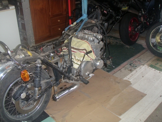

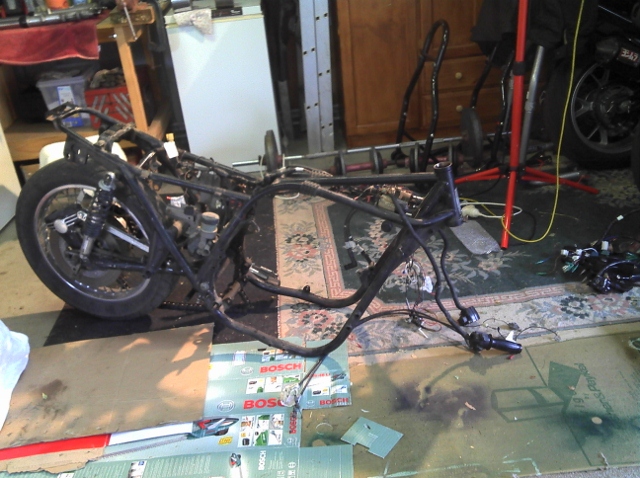

Finally have a little time and think I have figured out the taking pics, resizing business so thought I would try post a couple of pics
This is always the easy bit
- 3.jpg (241.87 KiB) Viewed 9346 times
- 4.jpg (222.12 KiB) Viewed 9346 times
- 5.jpg (224.44 KiB) Viewed 9346 times
- 6.jpg (203.57 KiB) Viewed 9346 times

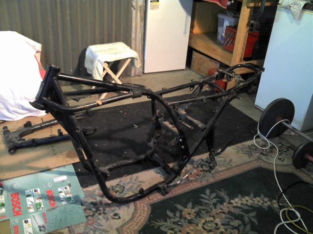

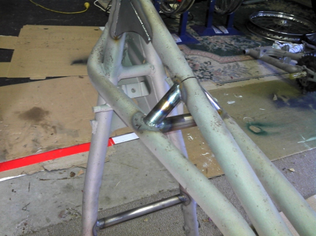

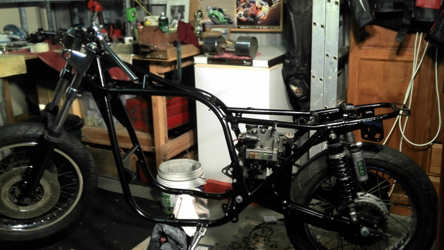

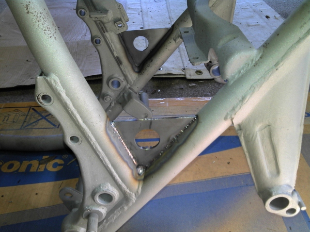

Next was getting the frame sorted, strengthened and powder coated
- 7.jpg (190.27 KiB) Viewed 9345 times
- 8.jpg (189.67 KiB) Viewed 9345 times
- 9.jpg (183.17 KiB) Viewed 9345 times

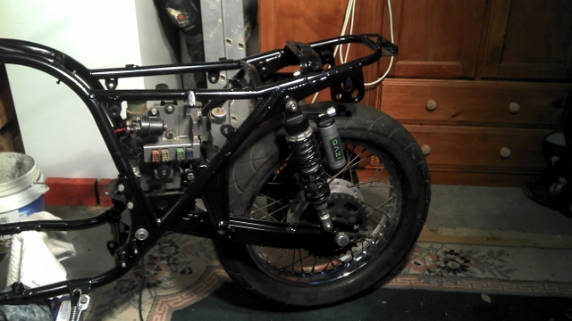

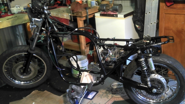

then rear end, GS1100 swing arm powder coated and fitted up with new shocks
- 10.jpg (153.62 KiB) Viewed 9345 times

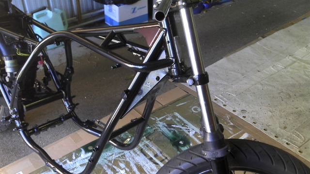

next job, front end with progressive springs and fork brace
- 11.jpg (179.65 KiB) Viewed 9344 times

and now the wiring to play with, great therapy that is
- 12.jpg (183.79 KiB) Viewed 9344 times

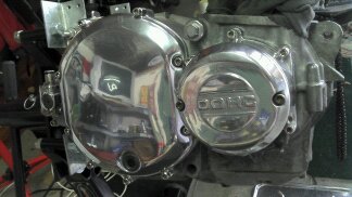

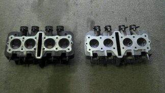

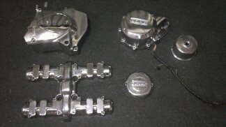

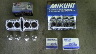

I have slowly been collecting bits for the rebuild and finally got a chance to get back to the old girl.
I went for 34mm flat slides and 1075 high comp JE pistons. I have had the barrels bored and am nearly ready to throw her back together.
Gos cleaned up the stock head for me so it is right to go back together. The other head is off an '83 Z1100 so will keep that for later mods.
Polished all the cases etc so she goes faster and started to make some progress until I snapped a piston ring putting her together today
Absolutely filthy on myself, oh well back to online shopping again.
- 34 mm carbs and 1075 pistons
- carbs 2.jpg (17.27 KiB) Viewed 9180 times
- '83 z1100 and stock heads
- cyl head 2.jpg (14.76 KiB) Viewed 9180 times
- bling
- covers 2.jpg (12.89 KiB) Viewed 9180 times
- engine case 2.jpg (17.59 KiB) Viewed 9180 times

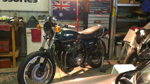

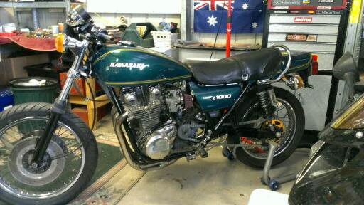

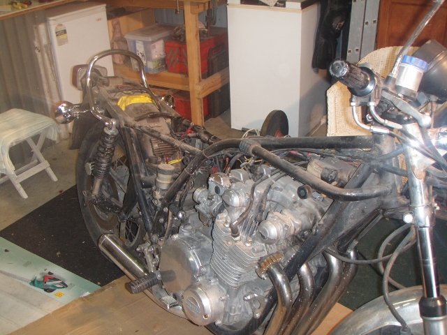

Slow but steady progress made lately but starting to get closer. Really looking forward to taking her for a run
- 1388815224811.jpg (44.99 KiB) Viewed 8782 times
- 1388815045859.jpg (44.69 KiB) Viewed 8782 times
