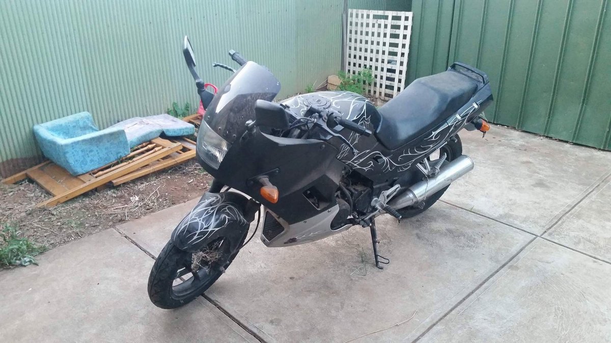

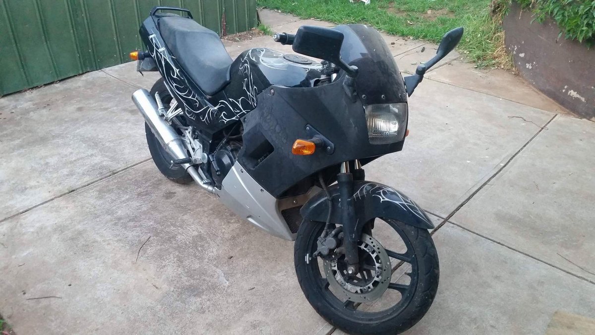

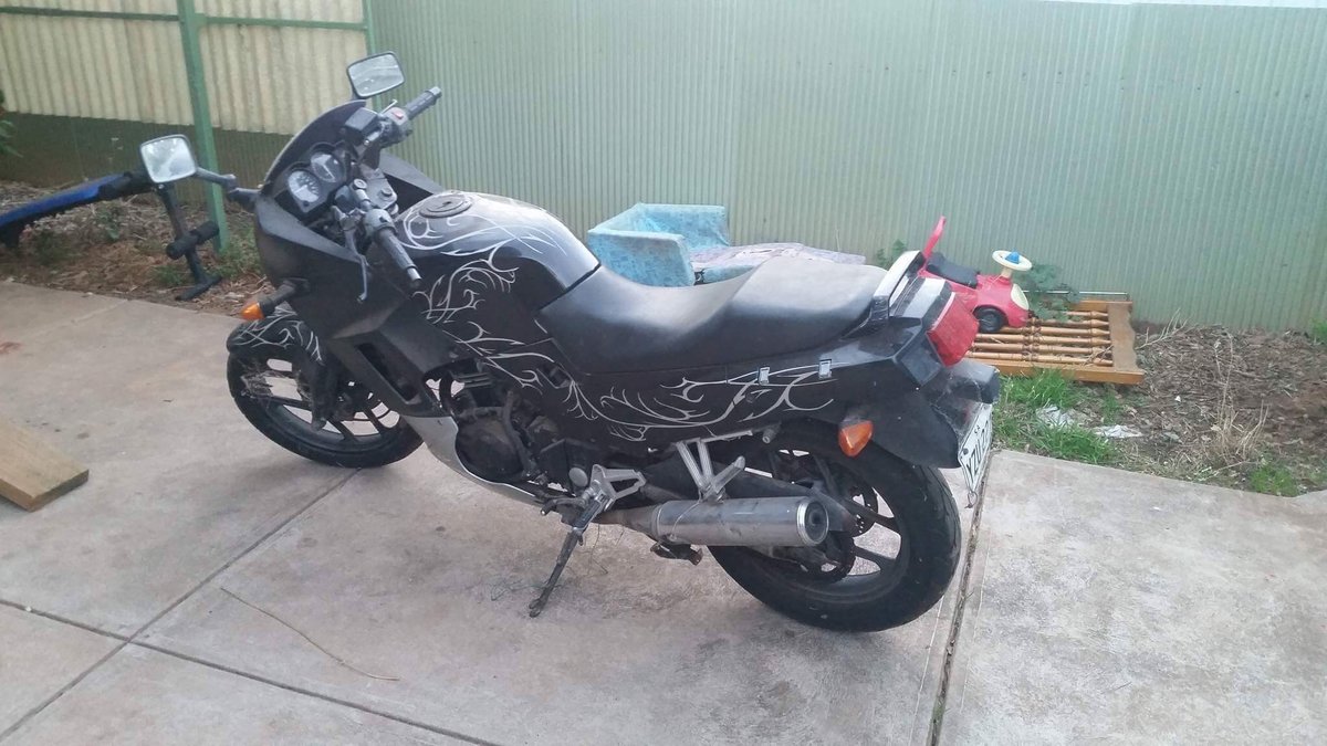

It did happen! 2006 GPX 250, come with a helmet and gloves that fit the missus perfectly. Should make a nice first bike for her. And cheeeeeaapp too.
Haven't done nothing with it yet. Doesn't start I'm told, battery is dead flat but apparently new.
From what I've worked out it's been sitting for about 2 years.
I'll give it a wash and get better pics when I can. Then clean carbs, clean and flush tank, flush lines, change fluids, charge battery, see if it goes. Much more familiar with bikes then I was 4 pages ago so confident I'll have it running over the weekend if I don't hit any snags.
One question to ask, handle bars straight, front wheel is cocked to the right. Something bent or something need adjusting/aligning? It rolls smoothly.
