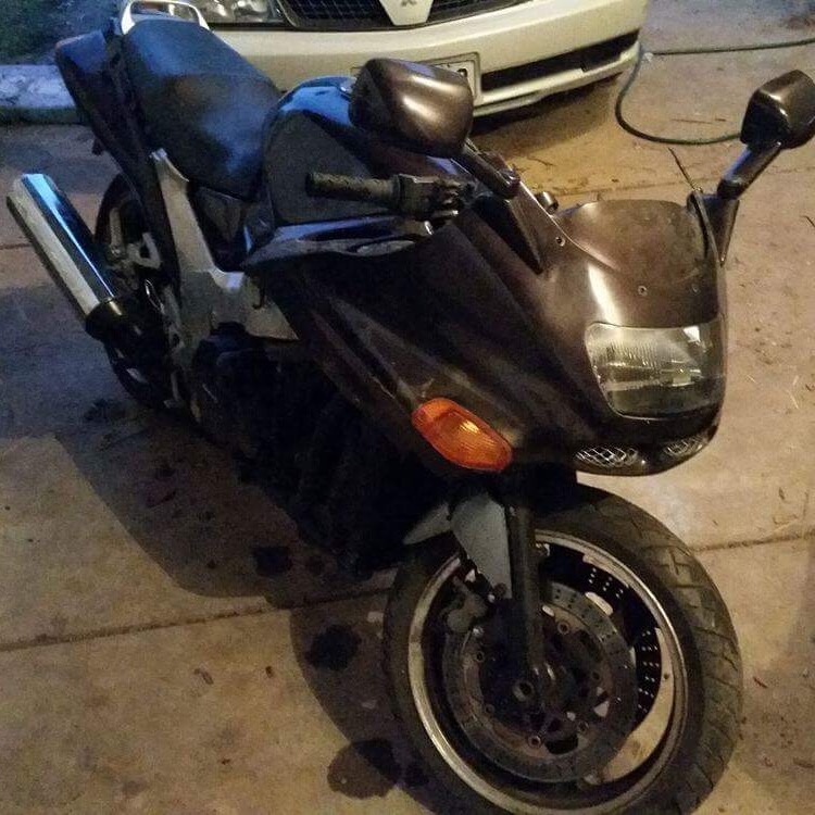

New member, first post.
Just acquired a 93 zzr, d model I believe, and hoping to get some advice along the way.
Firstly, here's a poor quality picture:
Bit shabby at the moment, has all the fairings but can hardly call them 'fair', plan is to fix them up and repaint in Kawasaki green/black, I may be swayed though. Any advise on repairing cracks, chunks would be greatly appreciated.
Missing the handle bars but I've seen a wreckers ad that has a bike in stock, although the ad is old I'll enquire tomorrow to see what's left of it in case I need. Fairings all look good but I imagine costly. My wind shield has a chunk missing but is out of sight when attached, would like a darker one but yet to ride the bike so no idea if I'll ever look through it or what the legalities are on that.
Haven't had a proper sus of the bike yet, bloke I purchased off said he got it to start, then next time he tried it wouldn't start, suspects fuel pump, said it kept priming or something along those lines. Noticed the tank is bone dry, so assume that's been off and drained while he tried to sus it out. If any suggestions come to mind feel free to share.
Now, the whole point of this post was for some advice, plan is to change oil, lift the tank to check everything looks connected, put some fuel in, turn the key and go from there. Any advice on things I should check or do before I attempt to turn it over? Small engines are one of the few things I've not dealt with and carby's are a mythical beast as far as I'm concerned.
Sorry about all the dribble and thanks in advance.

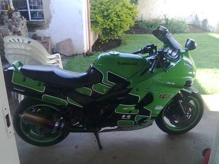

Yeah I agree that all green they look silly, I did see a picture of one on the googlewebs that was green/black that looked really tidy but I suspect it that have been a different model. I'll see if I can find it again. I have noticed they look nice in darker colours so I'll see how it looks once I give it a clean and throw it back together.

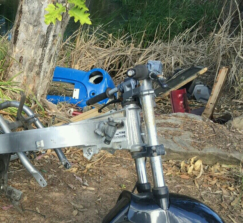

Small update, sourced some bars interstate. Small hicup with the seller stating pick up only. Fortunately had a member on the car forum nearby who is going to pick up and post for me.
But that means this weeks budget has been chewed up and will have to wait till next weekend to buy filters and fluids. So this weekend will be seeing whats missing, cleaning and fit the fairings to see how much love they need.

Can anyone tell from this picture if these bars are standard or not not, but more importantly if they will fit my bike.

Nevermind, got a better picture, they will fit and will do the job.
