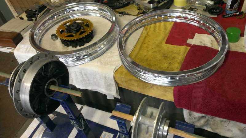

Alloy rims and new spokes arrived today. Hopefully get a chance to start rebuilding the wheels sometime in the next couple of weeks/months

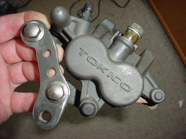

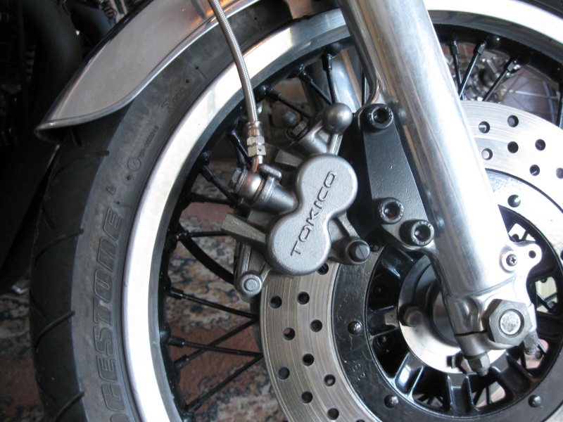

Was looking at these CP 5569 4 Piston calliper Kit Master with cylinder for $1150. Are they worth the dollars or are they WOFTAM?

those 4-piston calipers look great in the picture and would look awesome on the bike. Better brakes are available at wreckers for a lot less, but the issue then will always be having to make up the adapter plates - which you get in that kit. Personally I would just be going for a better m/c and braided lines, and better pads. The stock calipers work OK for normal road riding with just these improvements.......but if you have a few bob to spare, that kit looks the shizzle !!

Trying to get the balance right between building a bike that is a little bit special but not wasting too much money on stuff that doesn't make a great deal of difference either in performance or looks is the challenge.
I looked at late model radial mount callipers but making an adapter for them is a little more tricky. I was really thinking about doing something like this but using the later 6 pot callipers off the zx7 p model
The kit looks attractive because there is no rooting around, everything is included just bolt up and go
At the moment I will need new m/c, braided lines and pads, haven't split the callipers yet so not sure of what they are like inside so there is a few hundred to chuck at there anyway. Rebuilding the 6 pots off the zx7 are pretty expensive.

that 4-spot conversion looks good
not sure what the 6-spot calipers of the 7 are like, I know the 6-spotters on the early ZX12R were not much chop compared to later models.......they felt very wooden to me when I rode one years ago. Smithy will be along shortly to tell you otherwise
just need to make sure you have clearance on the inside - spoked- side of the wheel. There is not a lot of clearance when fitting calipers with bigger bodies.......they tend to foul the spokes. Just something to keep in mind ...

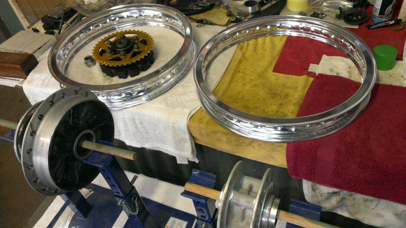

Wheels are all apart and ready for the next stage. I was hoping that I could anodise the hubs gold but it doesn't look like cast alloy will take the coloured anodising well. So plan B will most likely be to power coat the hubs black.
