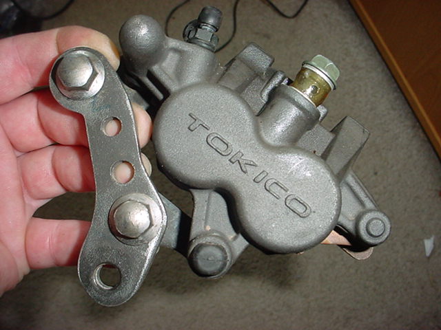

Trying to get the balance right between building a bike that is a little bit special but not wasting too much money on stuff that doesn't make a great deal of difference either in performance or looks is the challenge.
I looked at late model radial mount callipers but making an adapter for them is a little more tricky. I was really thinking about doing something like this but using the later 6 pot callipers off the zx7 p model
zx7 caliper bracket (640x480).jpg (69.04 KiB) Viewed 10188 times
The kit looks attractive because there is no rooting around, everything is included just bolt up and go :D
At the moment I will need new m/c, braided lines and pads, haven't split the callipers yet so not sure of what they are like inside so there is a few hundred to chuck at there anyway. Rebuilding the 6 pots off the zx7 are pretty expensive.

that 4-spot conversion looks good :kuda: not sure what the 6-spot calipers of the 7 are like, I know the 6-spotters on the early ZX12R were not much chop compared to later models.......they felt very wooden to me when I rode one years ago. Smithy will be along shortly to tell you otherwise :lol:
just need to make sure you have clearance on the inside - spoked- side of the wheel. There is not a lot of clearance when fitting calipers with bigger bodies.......they tend to foul the spokes. Just something to keep in mind ...
