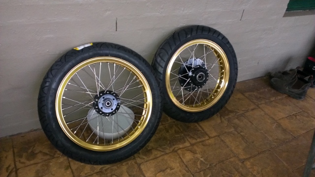

Found an anodiser in Mortdale (Sydney) who seemed pretty switched on working with motor parts. Pretty happy with the outcome, price was half what I was expecting :D

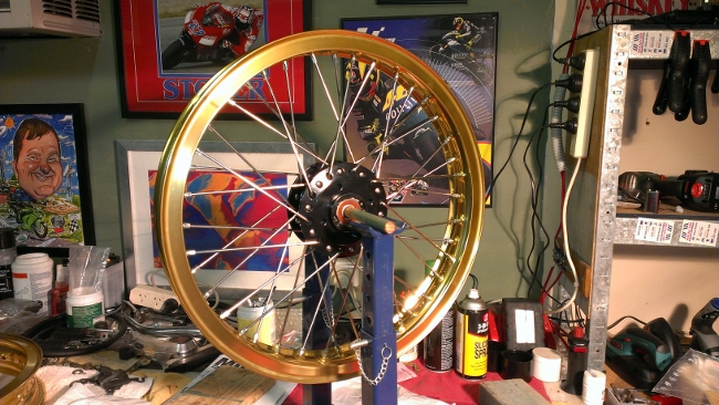

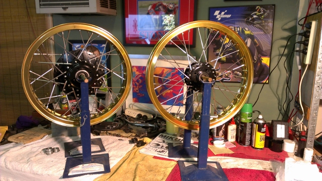

Powder coated the hubs and rebuilt the wheels this week.
IMAG0846 (650x366).jpg (249.43 KiB) Viewed 12987 times
Pictures don't do them justice as they look heaps better in the flesh.

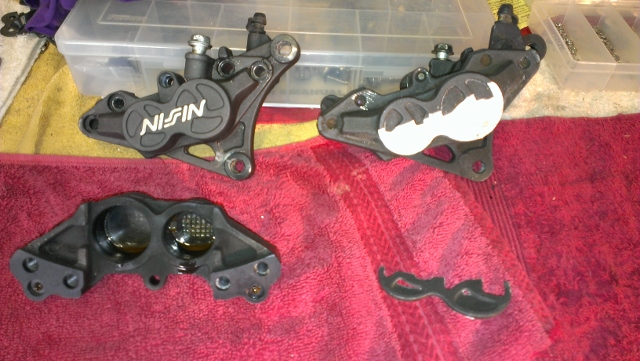

I have tried spacing the discs out by about 3.5 mm each side. This gets the rotors close to the forks but still with suitable clearance. I have sacrificed a set of Nissin 4 pots to the gods of motorcycling. I have taken about 4 mm off the inside of the caliper and they seem to fit ok. I think 4mm is maybe a little too much and think I could get away with just shaving off the pattern
IMAG0856 (640x361).jpg (200.93 KiB) Viewed 12947 times
This works ok at the moment but will need to take the same amount off the axle spacer and speedo unit to get it all centred.

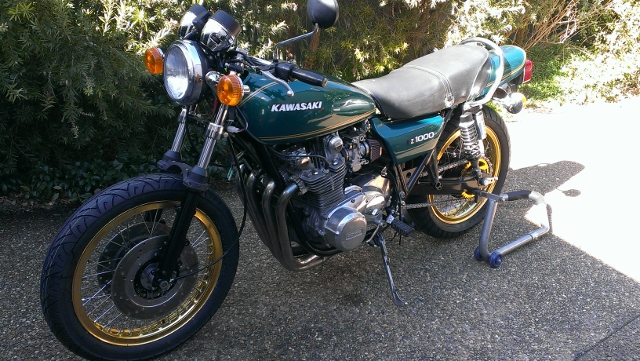

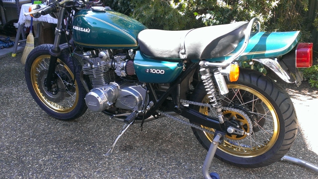

The old girl is coming along nicely so far, there are a few things still to do but getting close :D
Once I get the brakes sorted the rest should be pretty straight forward. I will get Mick to do the seat and then happy days.
