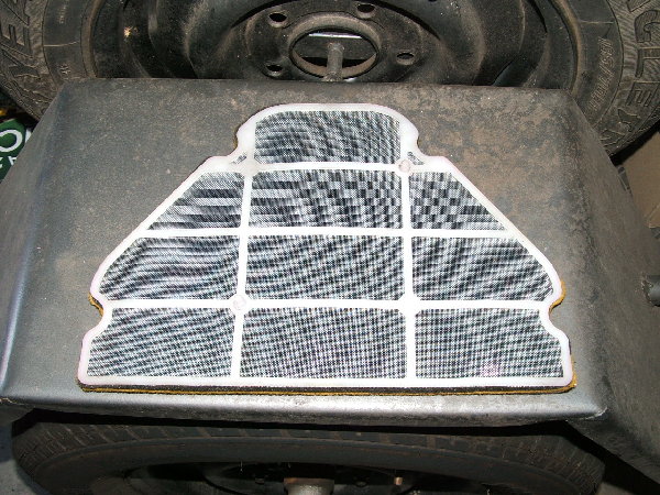

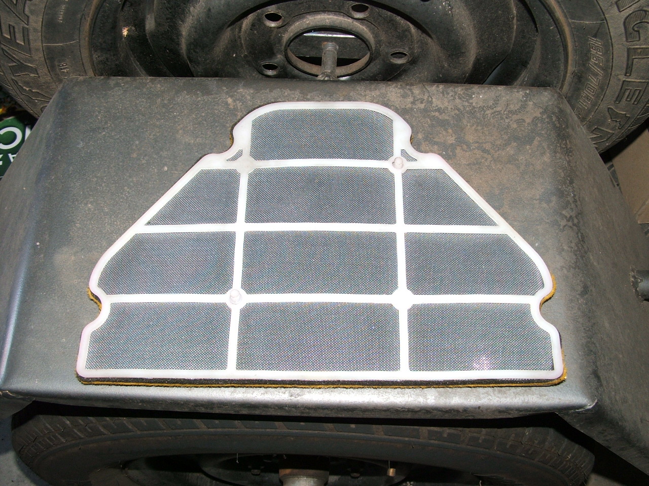

I've just pulled the air filter.
02ZX9R stock filter
02ZX9R stock filter
Hmm, the picture looks better on my screen than it uploaded. Anyway, my mesh is pretty well stuck to the grey layer of filter medium. Removing the mesh started destroying the foam. How much collateroll damage should one be willing to accept? What about the rigidity of the filter without the mesh?? Presumably you keep the plastic grid... I can see a disentegration horror story in the making otherwise...

Rossi wrote:I agree with everything said except for the air filter............believe it or not hte K&N air filter has 20% less surface area than the standard, that's why the race teams stick with the standard filter, but with 1 minor modification and that is to remove the wire meshing from the top of the filter and then wire the filter medium into place so it can't move about :wink:
Very interesting.

remove the white plastic grid.......the mesh stays ;)
Wash it in soapy water (petrol will melt the foam !)leave to dry and re-oil it.......the dirty bits stick to the oil with any filter -- stock or K&N

Well, with a bit more gentle pursuasion the mesh came off. For whatever reason, the mesh was stuck around the edges. Luckily, the damage to the filter foam was limited.
The plastic grid is a sandwich to keep the foam in place, so I've put the filter back with the grid but without the mesh. I'm about to take the bike for a run so I'll see what difference has been made.
