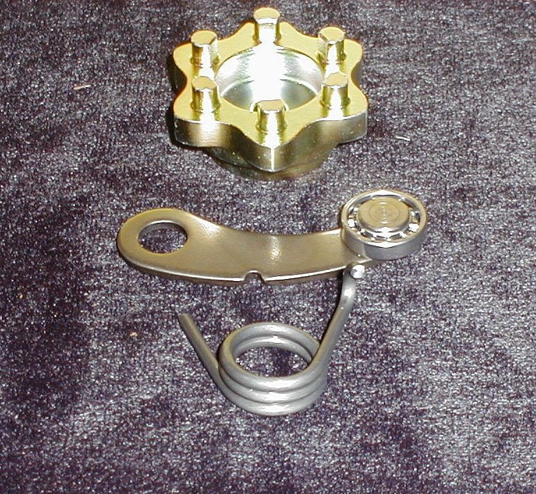

I will go with the oil change and also maybe it need a little clutch adjustment, I am in the middle of putting mine back together as a roadie a week before a trackday :roll: and am about to thrust it into service as a bike courier vehicle the pictures will come later.
you can get a mod for the gearbox its a spring and star thingy that makes them change better or so the manufacturer says and it isnt cheap either.

The shift star is a Factory Pro item & it available from Wolf Racing in Brisbane.
Mate & I put a new clutch in my 03 636 on Wednesday & had a quick look at it to see whats involved in changing it & mate said it will be easy, so all going right I should have it done sometime this year...
I emailed Wolf awhile ago about it..
Hi Michael,
Yes, we do have access to these kits. The Shift Evo Star kit retails for $305.00 Australian, and we should be able to get one to you in 2 weeks from order day.
Please contact us if you have any more questions, or want to order on 07 3206 3199.
Thanks
Ali
Dave and Ali Wolf
WOLF RACING
POWER PRODUCTS
ABN: 18103090517
Factory Pro Shift kit

been having a chat with a few people around the place and they all say fit the detent kit but not the star, I havent ridden my bike as a roadie in six months so i had forgotten about it but yeh it false neutrals a lot between first and second in stop start trafic.
I have a detent kit lined up for the next service or should i just bug the shit out of midclowns who are going to try to fob me off anyway.
