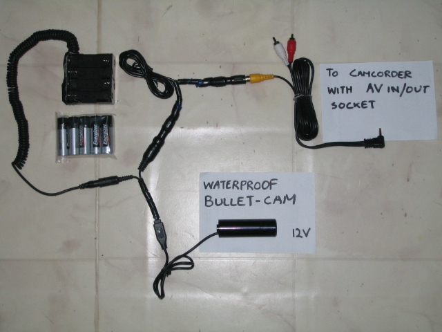

Just wanna try whether it's cheaper to set up a helmet cam myself with off the shelf parts and it is!
1) Bullet-cam - 1/4" SHARP CCD,PAL: 625 Lines, PAL Pixels- 320K,
DC 12V, 1.5 Lux = S$ 120
2) Connectors and cables = S$ 10
3) Battery Pack = S$4
4) No microphone for sound
Total spent=S$134 + some soldering, heat shrink cover for the connectors to make them waterproof, testing and time.(this exclude price of camcorder with AV in/out option)

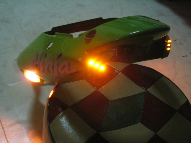

As for my ninja9 tail LED signals, it cost me S$20 for the amber LED which has 20 LED per strip, cut it to fit.Some minor wiring, drilling and soldering.
Did this cause my high mount pipe was blocking the right signal view from the rear. :)

Like the blinkers....
Will the camcorder still record the sound from the regular mic or will it try to use the audio that would usually be plugged into those AV cables?

Stereo wrote:Will the camcorder still record the sound from the regular mic or will it try to use the audio that would usually be plugged into those AV cables?
It will record sounds thru the AV cables but the mic need external power source to push the sound signals into the camcorder thru the cables.
Still looking for some high gain mic to do that Stereo :(

frogzx12r wrote:Like the blinkers....
Thanks frogzx12r, i'm just killing time cause i'm still on sick leave :lol:

okay then, how does the cam perform? if it is any good i may consider spending $135 to get some track day footage of my own

Mitch wrote:okay then, how does the cam perform? if it is any good i may consider spending $135 to get some track day footage of my own
Sorry Mitch for the slow reply, been busy lately cause i am starting work soon and currently doin my yearly re-tests for my job cause my job licence expired.
As for the answer i haven't been riding my ninja lately but i tried recording it while riding my mountain-bike, it records great except there's no sound.So i think i'll just add some good music to the footage next time :wink:

Sony make a lapel mic with a small calculator battery powering it. You need a powered mic to pick up the sound... but then you will need a wind protector to stop the wind rush noise.
The mic would plug directly into the handy-cam.
