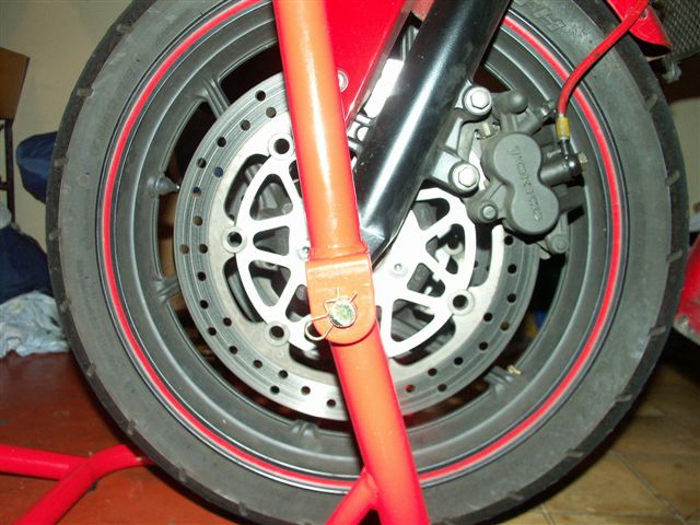

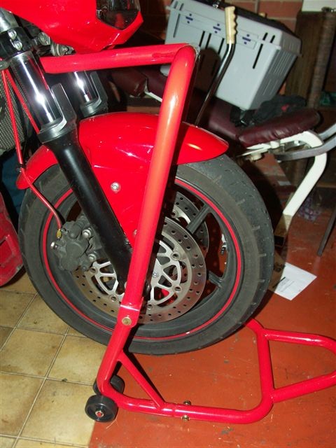

My description of the problem earlier was a little off, although the problem still exists.
The headstand doesnt run parallel with the forks - however, the point where the headstand sides cross the forks is right over the axel.
See pics below.
As far as I can see, the headstand is non-adjustable - the only putting together was bolting the wheel-base end to the upright section end, and inserting the appropriate spigot.
Side-on shot, showing headstand obstructing access to axel.
Picture 007.jpg (71.75 KiB) Viewed 3076 times
Bike on Headstand
Bike on Headstand
Picture 009.jpg (82.01 KiB) Viewed 3077 times

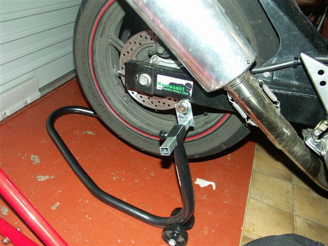

Bike on rear stand (showing obligatory KSRC sticker!)
Picture 001.jpg (65.8 KiB) Viewed 3076 times

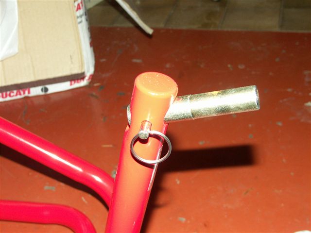

Headstand spigot
Headstand spigot
Picture 005.jpg (37.09 KiB) Viewed 3080 times

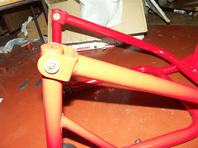

Headstand pivot point
Picture 004.jpg (49.73 KiB) Viewed 3080 times

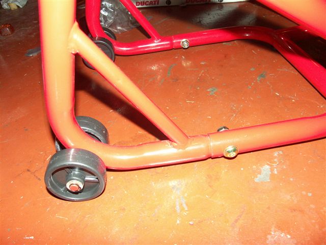

Headstand wheel base & connecting bolts.
Picture 003.jpg (53.22 KiB) Viewed 3079 times

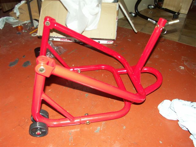

Headstand
Headstand
Picture 002.jpg (53.68 KiB) Viewed 3084 times
mmmm I see your point!! Makes it difficult to do tyre changes in between practice sessions for sure!!!! :lol: Bugger!!! Perhaps that won't be the model I look at then!!! The rear stand that matchesthat is the one I bought, and just to really piss you off, it's great!!!! :lol:
oh i see..thats a bitch!!
wot ud need to do is pull out axel bolt, then raise front & slide wheel out..bit of a pain in the ass tho i reckon... and prob hard to do without damaging sumthin..
thats a shitty design i reckon??
doesn't that suck :?
looking at the stand.... from a geometrical point of view, if that stand was completely straight shouldnt the front axel be accessible...
Not sure if you can adjust that at all....

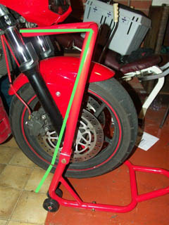

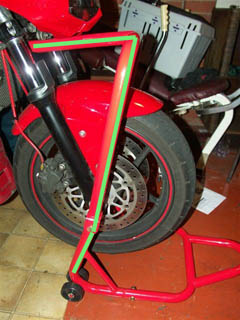

after
after
stand after.jpg (40.22 KiB) Viewed 3046 times
before
before
Stand Before.jpg (40.3 KiB) Viewed 3045 times
I-K
Posts: 1035
Location: Sydney (again...)
Post by I-K »
Why not just turn the bars a little?
I-K wrote:Why not just turn the bars a little?
I was going to suggest that as it works for mine, but this looks a lot closer the wheel / forks.
Mine also has an adjustable top arm angle so the position can be altered and it gives more clearance under the front fairing... cost a lot more too...
