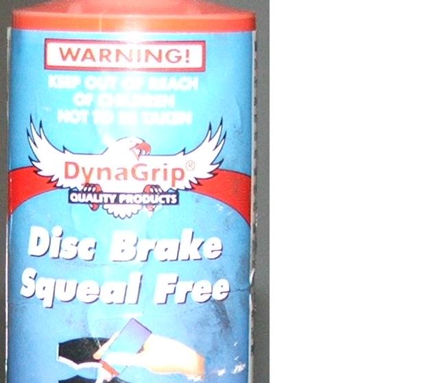

The pads i'm using are almost new but this was happening even on the old. As for the spray, before i rang i had a call from a mate (works on the 4wheeled mode of transport) and he mentioned this orange crap that he uses on cars called "Disc Quiet" from CRC, it looks like a glue bottle 115ml cost about $12 at auto shops (supacheap). Don't use as much as they say i only used enough to cover the back of the pad extreamly thin. Left to go tacky about 10mins, then put the pads back in. Pump and bleed the system. Went to Nasho and back absolutly pounded the breaks and not a sound. If it was that easy i would have done it months ago. I just hope this helps someone else out there.

I was just in the Garage and saw the botle of the stuff so here is the pic of the bottle. The docket had listed it as above but the bottle is totaly different. It lists it as "disc brake squeal free" but by Dyna Grip.
Sorry guys
