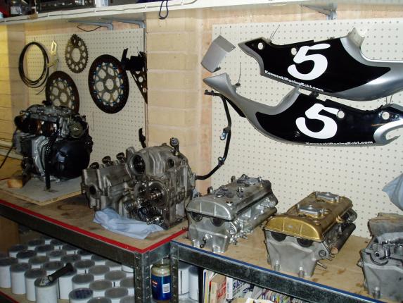

Well its been a bit quiet on the engine building of late due to the fact of me changing jobs so there all there ready to be pulled apart and first thing on the agenda is to knife edge the L model crank and balance it.
So many motors such little time.
Cheers,
Matt
Cheers,
Matt
- engines.jpg (66.56 KiB) Viewed 6949 times
