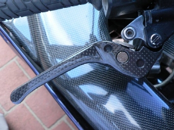

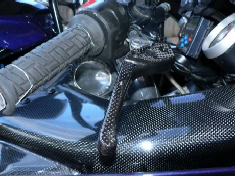

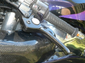

After I made the rearsets I got bored again so i tried making a set of carbon levers. I'm pretty happy with them.

Yes and no. You can use it just like fibreglass but it takes a bit of practice to get that nice carbon look. you also have to use certain resins. For all the structural stuff it's a different story again. i managed to get some off cut sheets from an aircraft production place which i laminated together and then cut, file, grind, sand and drill make the parts. It's bloody messy and takes quite a while to do (about 4hrs to do a lever) because it's so hard. it bluntens everything you use.
