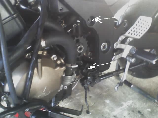

Ok whats the bloody go ??
I have undone everything (except my wallet to get a workshop manual)
I am sure there are only two bolts hold it in, either side of the swing arm bolt, but it wont budge.
Up inside where the bolts came out, there is (I assume) an allen headed spacer that looks like it screws into the engine, but from the parts blow up it cant as the top one has another spacer between it and the motor?
I am bemused that the motor is only held in by two bolts at the back but why wont the sucker fall out now, the frame cant be THAT bent surely ?? :shock:
I dont want to start using undue force YET, and as I havent got a big enough allen key I will leave it until tomorrow now and see the dealer anyway, but FARK I hate it when I cant work it out myself...
Since when did an aussie need instructions :twisted:
these suckers.JPG (32.72 KiB) Viewed 5519 times
THe swingarm bolt might go through the back of the engine too...

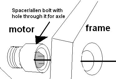

I-K,
pardon piss poor drawing, when you drop the bolt out the space for the allen key is inset into the spacer, which it turns out is a hollow bolt/spacer.
Hope this makes sense of it. The bolt goes through the lot (represented by the thick black line) you screw the spacer/bolt in out and the motor is released from its outward pressure. :shock:

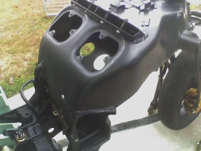

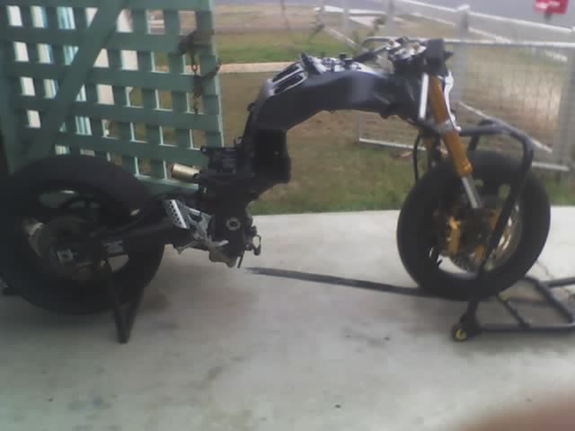

the next pics are teh 12 sans motor and the next the monocoque that I rave about and is now in the 12, 14 and new 10 (apparently). It is the airbox and battery box as well as frame, wicked eh?

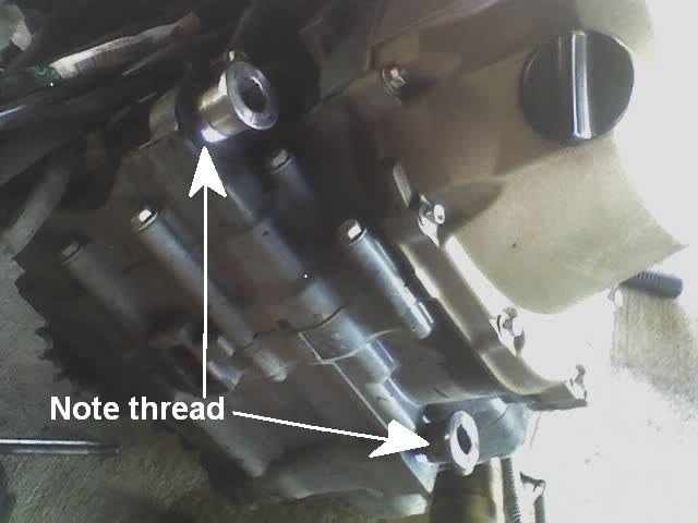

I should just take a pic of the motor out yes ?? :lol:
(goes downstairs, rolls motor on left hand side, catches ball sack on exhaust pipe, screams, drops motor rest of way, crys, slips in fuel, takes photo, crys, limps upstairs, wonders if he should post photo of ball sack first, decides it is not a good idea as MotoP is in warmup and not enuf will see it)
Here, *gasp* is a pic, v of the motor *gasp*
threaded spacers.JPG (27.39 KiB) Viewed 5478 times

wow that frame looks funky :D so whats being done to it while its in this stage? any polishing or painting?
nice to see the engine finally came out........
History Lesson #1 - that ZX12 frame actually has its roots in the spectacularly unsuccesful KR500 GP racer of 1981. This bike used an aluminium monocoque frame , smaller overall dimensions of course, but basically what Kawasaki did in 1981 with aluminium, they copied in 2000 with the ZX12R frame...........
everything old is new again. Here endeth the lesson
