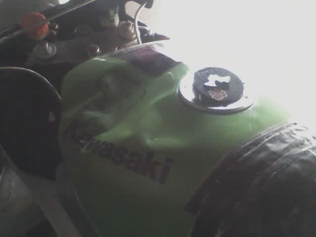

Ya mean like this :lol:
7 dent.JPG (15.86 KiB) Viewed 6583 times

Tape - if its very similar to the size dint i had in my tant on the 7.
Paint free dint removals wont touch you
They don't pop dints out anymore, so they have to pull it out and respray.
If it's being used as a track bike, I'd either a) leave it, or b) bog it and see what happens.
Depends how much $$$ you're puttin on a paint job, if you 're just buying a few cans of matt black paint, or going somewhere to get it done right

Ok cool, well in that case it all depends where the dint is,
Mine was on the crease line of the tank (roughly the size of 20c peice) like from a bar end or something.
I got quoted about $500 dollar mark for it to be pulled out and repainted.
Explored the pop-it-out-with-compression. however, they dont do that anymore because they can accidently blow the seals inside the tank instead of just bashing them over the head like mike-s does with his standard exhaust.
I rang a few paintless dint removalists, they wont touch you (with bike tank dints).
Best of maybe prepping it yourself, seeing how the bog goes, and then maybe just paying someone to pull it out if the bog failed before getting it painted, would be reasonabily cheaper.

Mick,
if you're gonna use bog here's a tip for you :wink:
roughen the paint surface a bit with wet & dry then apply the bog straight away stretch gladwrap over the applied filler ......... it'll pull the filler into the shape of the tank and the last time I did it all I needed to do was putty over it before painting....none of the tedious sanding to get rid of the overfill :wink:
it comes down to how tidy u want it to look i think mate.... if ur gunna try to make it look like a show bike, id go all out..if its just gunna be a nice roadie, id put up with it...matching paint etc is a pain in the bum...have u tried to find a new tank thats not damaged?? or too $$??
mate just bog it.
its not that big

mrmina wrote:mate just bog it.
its not that big
i agree, i did a similar size one on my katana tank about 5 years ago,wouldnt even know its there........... :)

I would say bog it, or option 2 put an ouch!! sticker over it :lol: :lol:
Lucas
Posts: 495
Post by Lucas »
Bog it
but i'd say remove the paint in the area to be bogged
