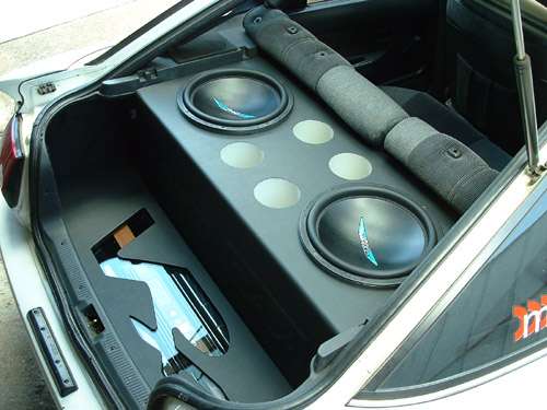

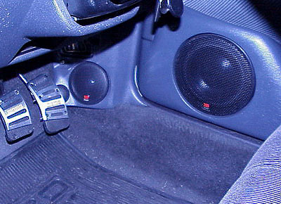

depends how far you want to go..
I've done SPL and SQ comps so it just depends on how far you want to go and what you expect.
Also the car itself can play a big part in how you get the stuff in...
What are woudl you like? single cd head unit no stacker? would save costs, maybe go an mp3 deck.
splits in the front, the general thing in aus is tweeters sitting up on the dash/A Pilar. Rears are just fill.. aka pasenger comfort, and then the sub, which should pick up where the fronts left off, down to 20hz.
you'd prob be looking at 6 1/2" 2way splits. 6" coax's in the rear. And a sub, my pref is 12".. So you could get away with a 4ch amp, run the rears off the deck depending on the deck, fade to the front 3-5 points so they mix well, and a deck with a SW output so you can tune the sub up and be able to turn it down.
That would be my set up...
If you want loud, I can assist.. My old car was 147.5 dB from 1 12" and I help build aus's loudest car (Dunno if it's been beaten in the past 2 years) 165.9dB from memory. Also competed in SQ comps, etc. So if you want a hand Eelko let me know. I also have a mate at JB for prices, and a mate that imports Audison, Morel, Hertz... Hertz stuff isn't too bad.
You know you want some doof doof...

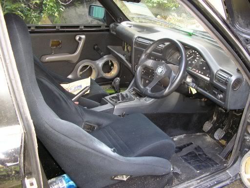

I brought a scruffy old 1983 BMW with the remains of an interesting install.
I'm tempted to at least replace some of the missing goodies!

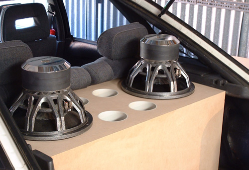

So ummmm yeah, fill the floor of your boot with fiberglass, build a 4 x 12 inch sub enclosure, add backing plates for 4 amps either side, 6 inch speakers in parcel tray, component and split 6 inch speaker pairs in each door and a head unit........and earplugs.
