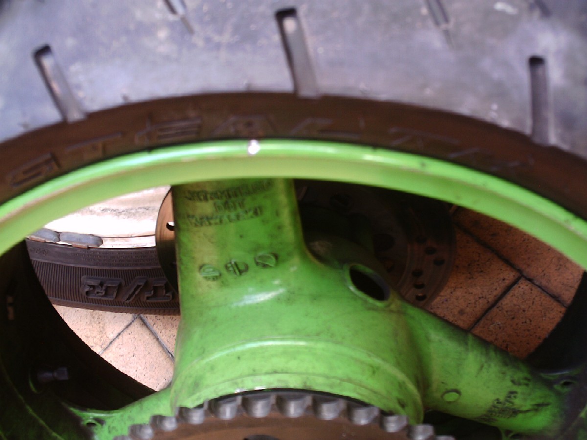

went to work this morning, parkd my bike and started work, wen finishd
work came to the bike an saw the rear tyre flat, said to my self o no but
when I look for an object that made it go flat I found a big nail shuved
between the rim an the tyre, no way in the world that could've happend
on its own, so rode the bike slowly to nearest servo and put some air in
it to get home, got home, how ever air is stil comn out and the rim is
slitely groved cause the nail and tyre not sure about and I just bought the
bloody thing, does any one know if this prob can be fixd ?

I know thoughts tend to go through the head and I quickly start blaming people yes that does happen but this nail was strait as and is about 5", 3" of it is in the tyre I would've been level with the tar to get this nail that far in, I asuming I must've taken some one parkin spot for this to happen cause I just started job beginin of this wk

It's hard to know if it's fixable without looking at it... I'd rid the wheel off and head down to your nearest Bike shop.

I don't think tyre sidewall puncture can be fixed.
But the rim itself, I would go to supercheap auto to buy that steel putty thing (hard as iron when cured).

Without seeing it,but i reckon you could fix the rim easy.The nail has put a groove in the rim and this is why the tyre is leaking.Attack the rim with a file and then smooth it with wet and dry.It doesnt have to be perfect,just smooth enough so the tyre will seal against the rim again.Maybe a good idea to get the wheel rebalanced again afterwards.

Where it is like that why wouldnt they just vulcanise a patch on the inside ?
Try somewhere like Bob Jane instead of a bike shop I guess.
