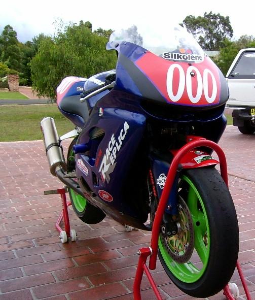

I had mine fixed through the front (number area) of the fairing into the instrument support bracket.
On my 7 I have a clip in the fairing above the mudgaurd that also fixes to the instrument support bracket.
Both the brackets are specially made though...

Hey Rusty with the rear how much of the original undertail is cut off. It looks like it needs to be cut down to the battery box and a new piece fitted to fill the gaps. Mine is a real bitch to get on so it's not yet...
MadKaw was yours bolted straight into the instrument support bracket or did it have grommets, spacers etc?
- MadKaw
- Administrator
- Posts: 9672
Mine had an aftermarket instrument support with an alloy tube projecting out to the front to pick up the fixing.
The pic below shows were it was fixed.
- zx9-9-1-05-4.JPG (73.31 KiB) Viewed 4018 times
